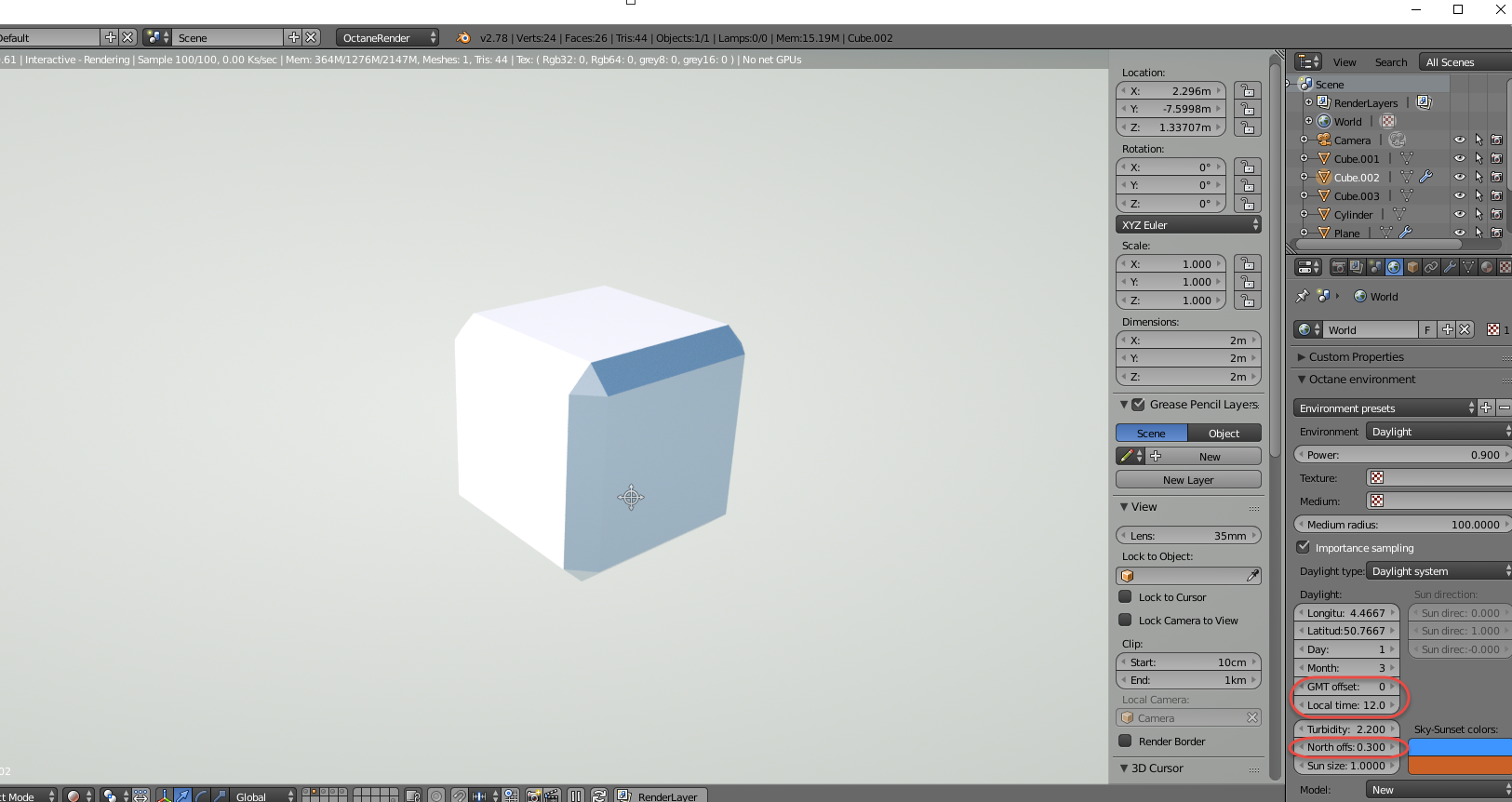

Hi, Daylight settings are not working.
For example North offset, Local time settings does nothing in preview and final render.

Hi Saramary , thank you for testing, I use settings in Octane importance sampling not Octane environment. :oops:
No idea what they are for.
Is working fine.
