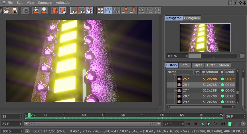

Hi mates, thanks for the responses,
here's the screenshot, I'm stuck here I checked everything!, it seems a bug, In octane's live viewer I get the lights (difusse material with blackbody emission) with, post fx etc, but when I render in the C4D viewer they are gone.

Re: Different render result than the live viewer
Posted: Tue Sep 06, 2016 9:26 am
by bepeg4d
Hi deifgiri,
adding a screenshot is always a good idea :)
Check your Octane render settings and in particular, the Geometry Engine:
https://docs.otoy.com/manuals/products/ ... rendering/
If is setted to "Send all scene data", all the geometry is collected in one single object and the power of the emission is divided by the number of emitters losing power.
So the emitters are to weak and the Post effect cannot work as expected.
ciao beppe

Yes I already tried that,
changed to 'Resend only updated objects' manual , all and auto,
it renders the first frame just fine, but the following ones are dark again.
You said they emissions are weak, If I push the emission power way high, I get some light in the render, but I still can't understand why is so different from the live viewer yet,
well, I guess the scene is not well done...
upping scene
Posted: Tue Sep 06, 2016 2:27 pm
by bepeg4d
Hi deifgiri,
there is definetly something strange in your scene, the post effect is there, but the emission power always changes after the first frame :roll:
The scene still has the "Resend all scene data" option, please change it to manual or auto.
The workaround is to copy everything in a new scene, here now is working as expected.
