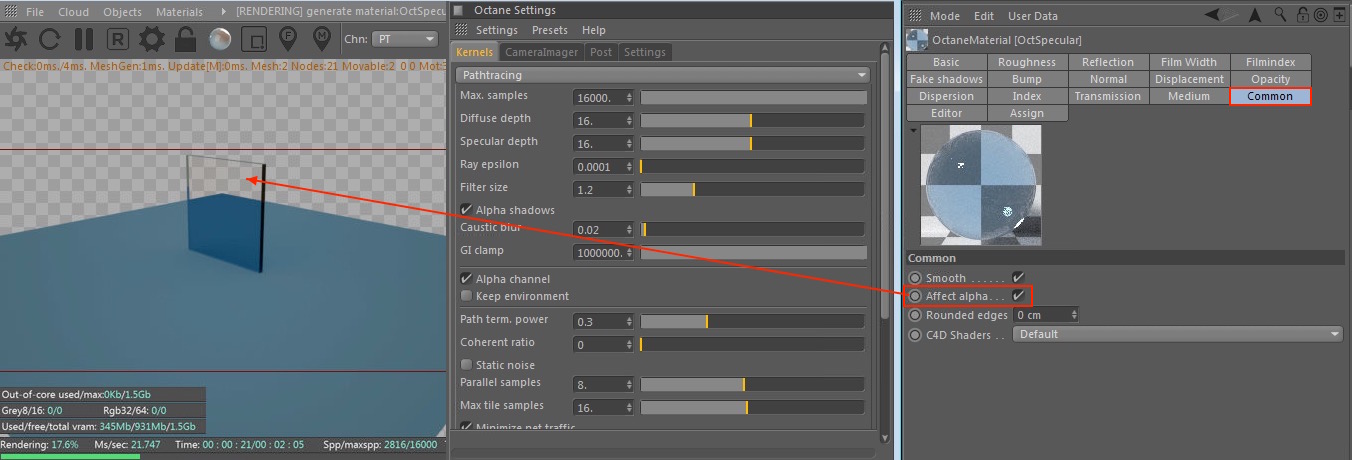

I use Specular material
when checked alpha channel but see environment over the glass material
why?
Re: How to alpha Environment ?
Posted: Mon Aug 08, 2016 8:19 am
by bepeg4d
Hi D994083,
you need to go to the Common Tab in the attribute of the specular material and tick the "Affect alpha" option:
ciao beppe

Thanks bepeg4d!
