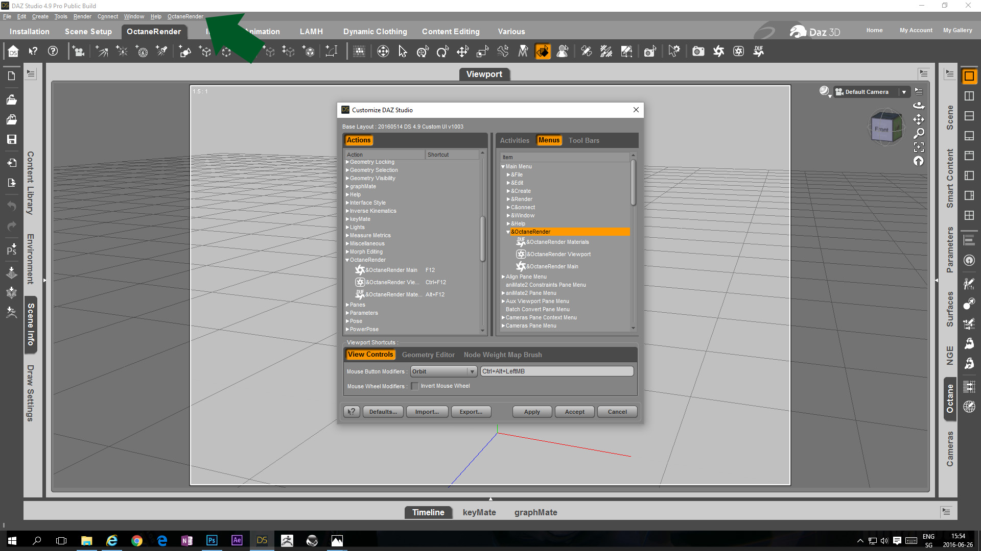

Short version:
Based on my quick experiments there is a low probability glitch that entries of the main menu that should be added to any workspace are omitted.
Just select another layout and then switch back to the one you want and then the error should automatically be resolved and all main menu entries should show up again.
Longer version:
As far as I understand it OctaneRender menu entries should be added automatically to
Main menu
Render
-> The best way to check is to open the "Customize DAZ Studio Menu" by hitting F3
On the left side you can see all the available "Actions".
On the right side left of "Activities" there is a sub tab for "Menus".
The first entry should be called "Main Menu" then there is a sub directory for "&Render"
There you should be able to see the entries:
&OctaneRender Main
&OctaneRender Viewport
&OctaneRender Materials

In this example the entries show up properly:
I quickly tested all available layout presets and each of them worked eventually.
Nevertheless I did notice that at least once the Main Menu entries were not added on first try.

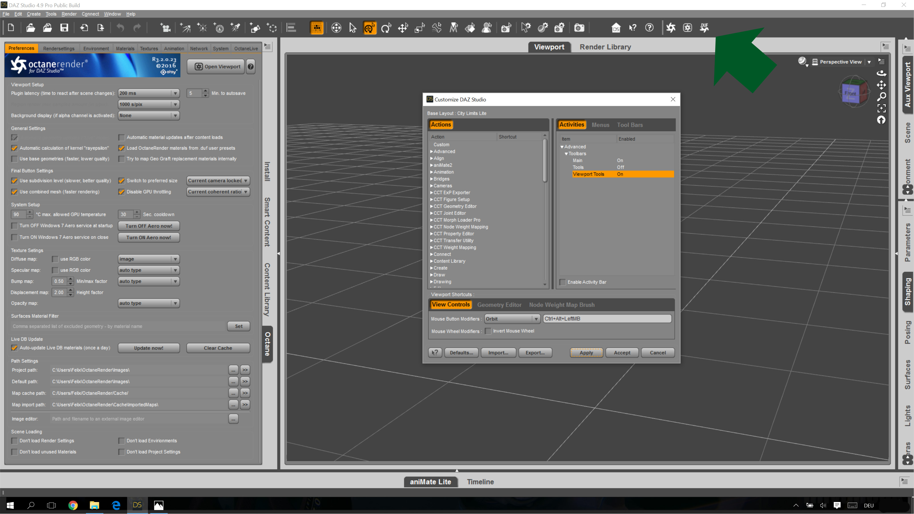

Posted: Tue Jun 28, 2016 12:57 am
by linvanchene
Just tried out how things look with the DAZ Studio 4.9 default UI on my laptop.
-> There is a chance that the Octane related actions are not displayed in the toolbars in some of the DAZ Studio layouts if the toolbar "Viewport Tools" is set to "Off".
To quickly fix this:
- Press F3 to open the "Customize DAZ Studio" window
- On the right pane select "Tool Bars"
- check if the Octane related actions can be found in the "Viewport Tools" tool bar
- On the right pane select "Activities" and check for each (!) activity if the "Viewport Tools" are toggled to On
-> With the "Viewport Tools" switched "On" all OctaneRender related actions now should be displayed in the upper right toolbar location.
