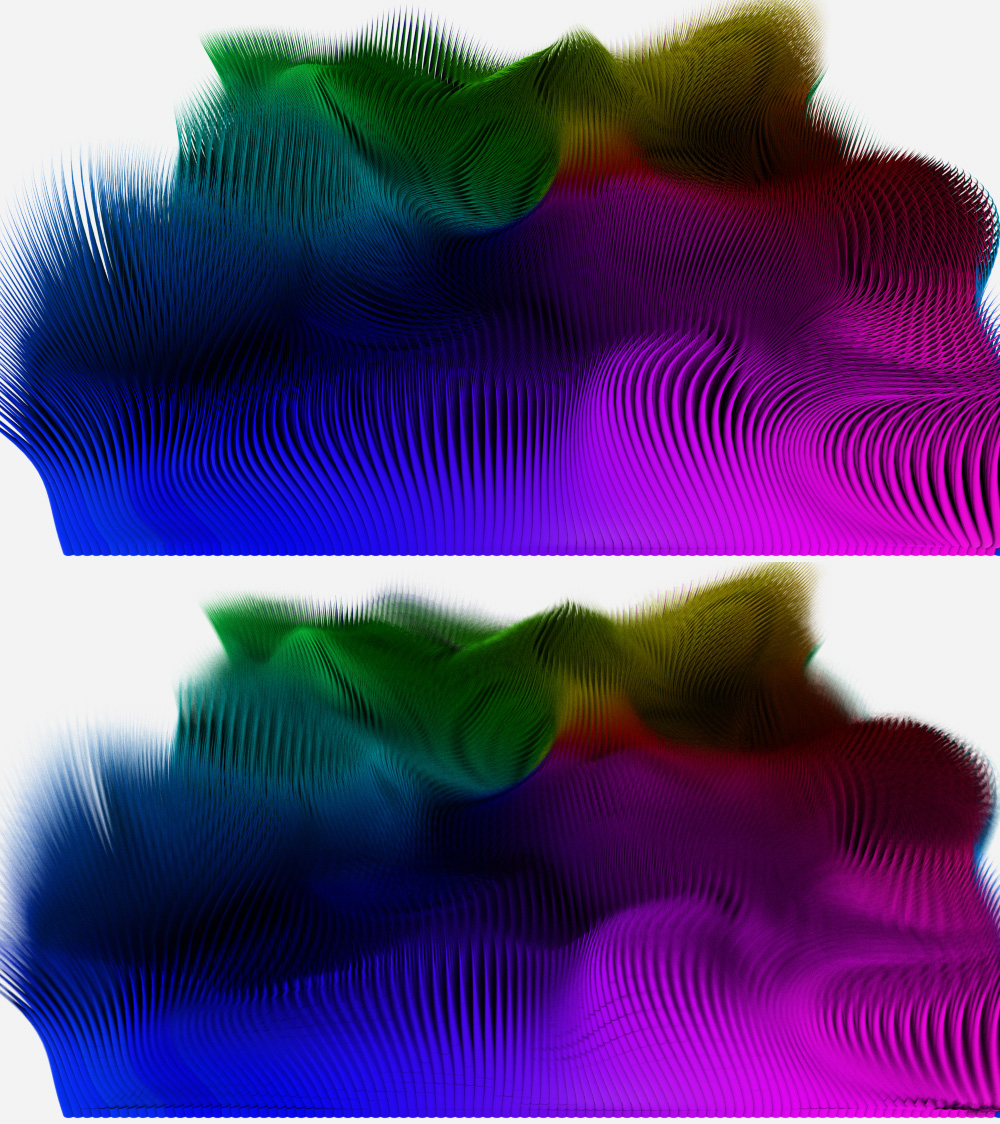

Done.
But it isn´t perfect. It´s an Octane problem.
Each strand segment is a single open ended cylinder, so you must also subdivide a deformed strand much more than a strand which has no deform.
This will work for non motion blur strands, but it wouldn work with motion blur, you will ever see some segments.
So my conclusion is, motion blur for strands works, but i wouldn´t use it.
