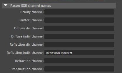

Right,
there is a mistake in the default names for composite EXR channels.
Reflection Indirect channel use the same default name as the Diffuse Indirect channel.
In the meantime you can address this by not using the default name for this channel.
like this:

Thanks.
Naming the passes explicitly did the trick.
Should've thought of that sooner
