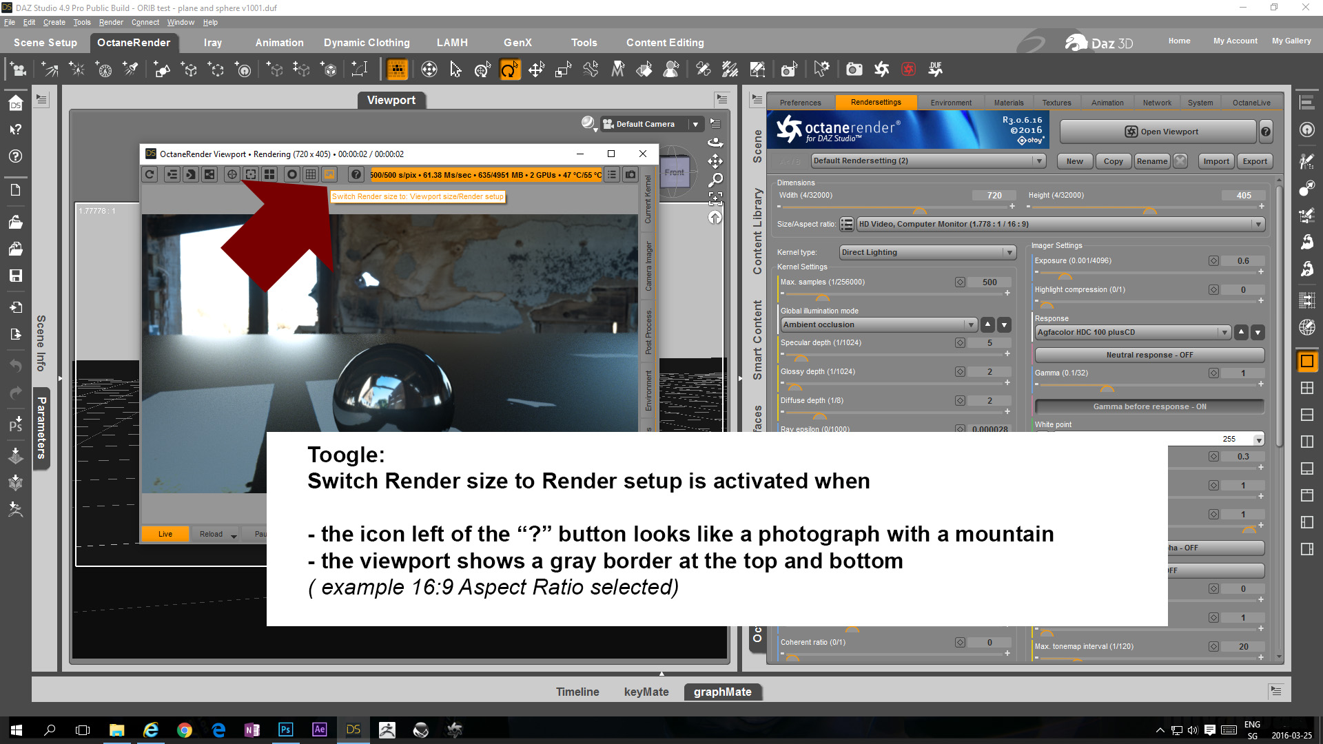

Possible Reason 2: Viewport / Render setup toggle
Make sure that you do not have by accident toggled on the Render Viewport setting which will ignore any selected aspect ratio.
Aspect Frame - Render setup is selected when photograph icon with mountain is showing
Aspect Frame - Render setup is selected when photograph icon with mountain is showing.jpg
-> This means the aspect ratio and render resolution from the OcDS Render Settings tab are being used.
Aspect Frame - Viewport is selected when double sided arrow is showing
-> This means the OcDS plugin viewport size defines the aspect ratio and the render resolution.
You can also right click anywhere in the OcDS plugin viewport to switch to the other state depending on what is currently activated
- Render to Viewport size
- Render to "NUMBER OF SELECTED RESOLUTÎON
-> In order to reactivate a hung up DS OpenGL viewport aspect frame make sure the Aspect Frame - Render setup is activated before trying to change the ratio or resolution.

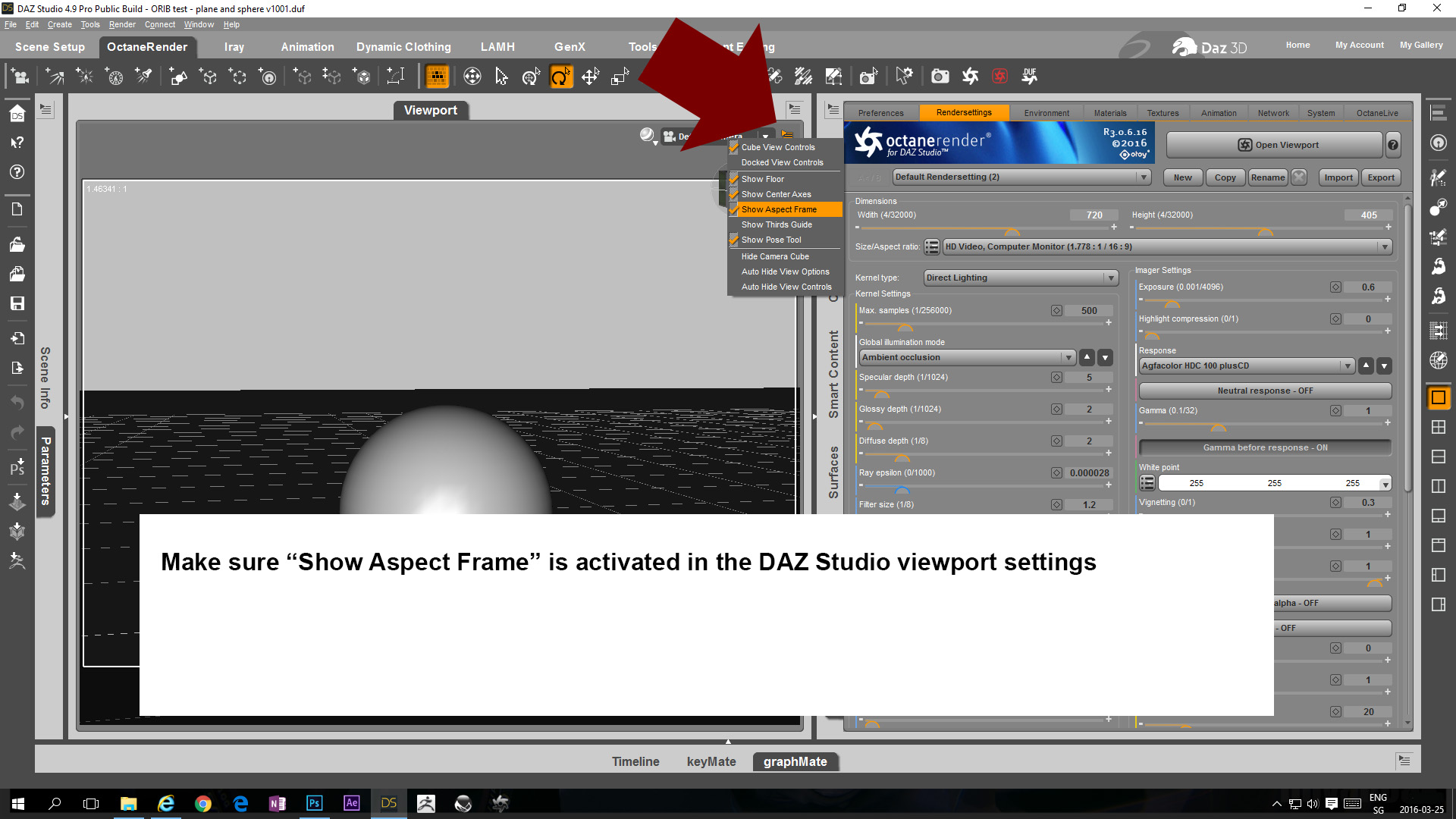

Possible Reason 3: DAZ Studio "Show Aspect Frame"
- Make sure “Show Aspect Frame” is activated in the DAZ Studio viewport settings

THANKS!!
It was number 2
