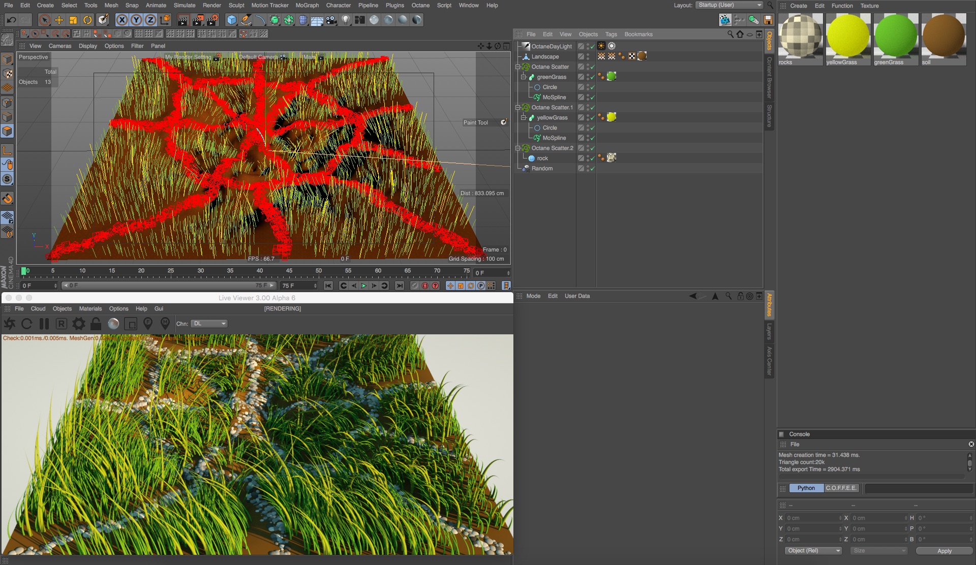

Hmmm looking a bit at scatter I realized it is the cloner but just a lot better (and damn it is good!)...but sadly it doesn't solve my question how terrain is painted with multiple materials.
Re: Exterior Render Gravel / Pebble Instances
Posted: Fri Mar 11, 2016 12:55 pm
by bepeg4d
Hi AutoactivaGmbH,
do you mean something like this?
ScatterObject.c4d.zip
(387.96 KiB) Downloaded 350 times
ciao beppe
