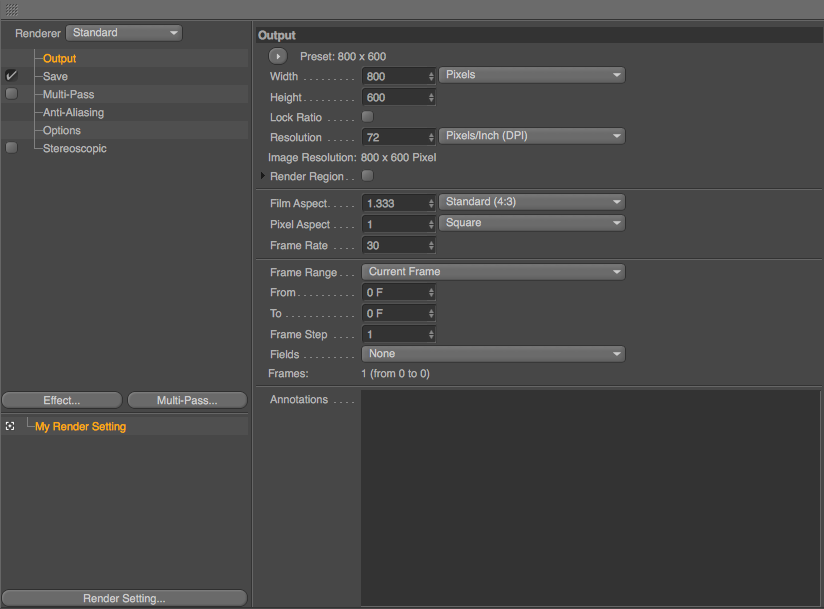

I just purchased Octane for C4D. When I tried the demo the LV was fast, I could pan around a scene and it would refresh in real time with no problems. Now with the purchased version, everything seems to be going a lot slower.
If I start the LV I am not able to pan around the scene, change settings in materials, not even select a different object in the scene, this is really frustrating. And I only have two planes in the scene (floor and wall) and a Platonic with a glossy texture and two Octane Lights, I'm just trying to learn Octane.
Here are my render settings:
Current Octane Render Settings
C4D Render settings
C4D Render settings
Here's my wokstation info:
Macbook Pro Retina 15-inch Late 2013
2.3 GHz Intel Core I7
16 GB DDR3
NVIDIA GeForce GT 750M 2048MB - I know this is not the best for performance, but it performed well with the demo
OSX El Capitan 10.11.1- I was running Yosemite when I played around with the Demo.
*I have the macbook hooked up to two monitors, already tried just using one monitor and it didn't get any better*
Any help would be really appreciated. I don't know if updating to El Capitan is messing up my workflow, or if I am doing something wrong with the render settings, but before, I had reflections, blackbody emissions and a bunch of objects in the scene and I was getting a much better response from Octane, which is why I decided to buy it, even tho I know I don't have the best hardware for it.
Thanks!

if you're comparing same scenes on demo and commercial versions, they are same. But you should check gpu section and select priority options. You're one single and slow graphic card. Octane and viewport shares the power of same card. If you don't select priority so Octane will use most of execution time of gpu. Simple enough?

Thanks for your reply. Yes I know it's not a great Video Card. I actually went thru the settings and ticked 'Use pri' for my GPU and it started responding A LOT better. I am able to do everything as before.
