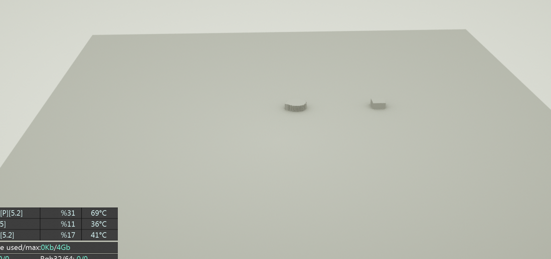

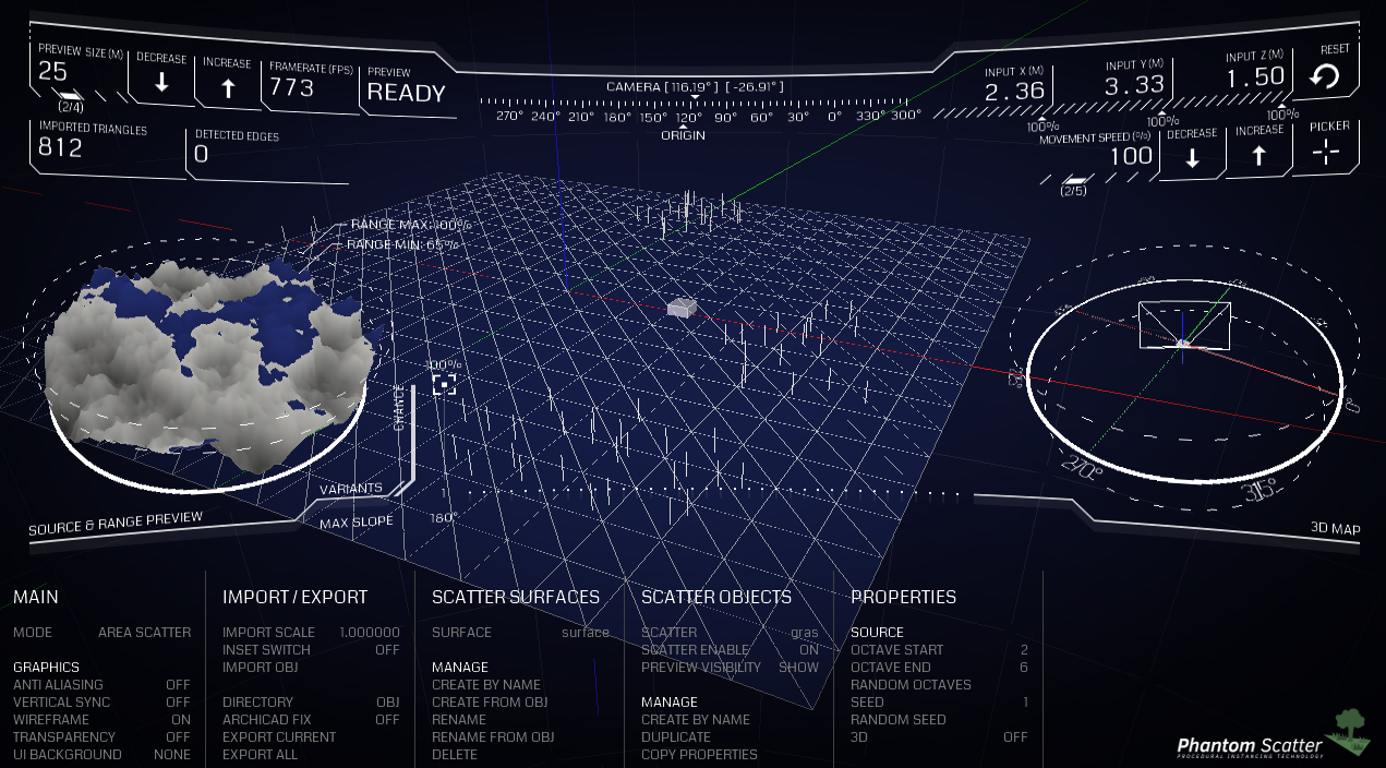

when i load a csv file from phantomscatter in the octane scatter in c4d the coordinates are scaled down.
in phantomscatter: in c4d: when i open the scene in octane standalone i can see that the coordinates are not the same as in the csv file: it seems that they are scaled down by a factor of 100
another test:
another test:
