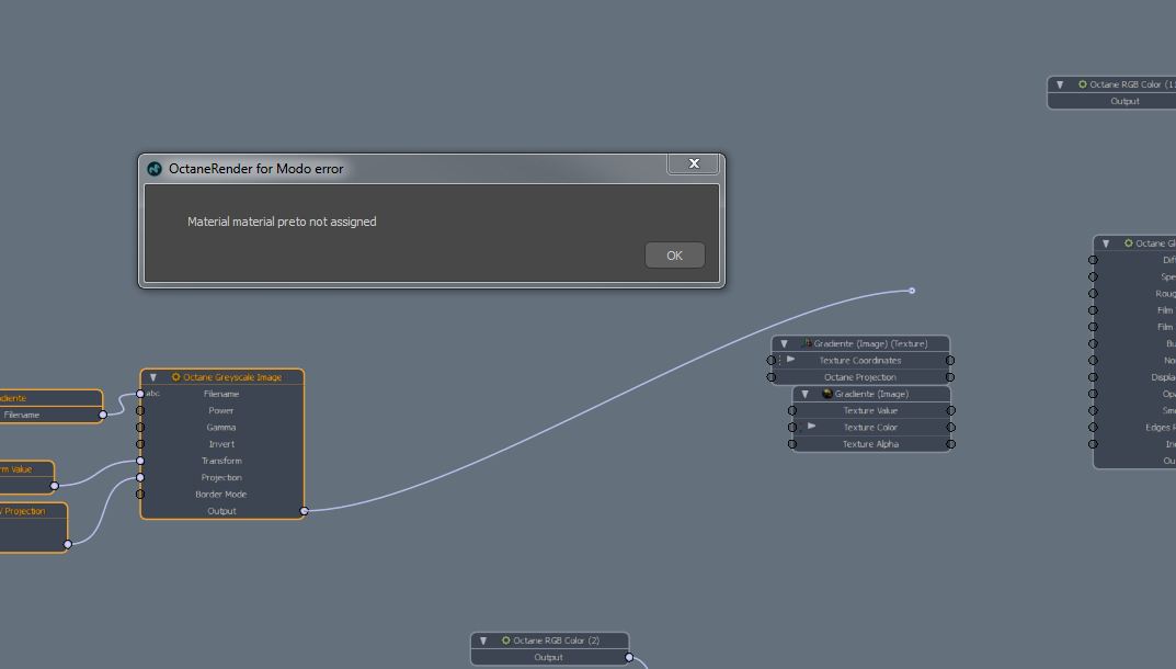

Hello guys.
Lately i've been getting this error:
It is trigered everythime i change a node connection in the schematic view.
happens in multiple scenes with nothing in particular about them.
also happens in a sequence , like:
material "x" no assigned. i hit ok
Material "y" not assigned, i hit ok.
and it goes on and on in a way that i simply hold "escape" to dismiss it all.
Any ideas on why this might be happening?
Thank you.
Cheers
Raf
Re: error 901 SP1 & SP2 - Material not assigned
Posted: Fri Sep 18, 2015 12:17 am
by face_off
Hi Raf. This is a debug message, and shouldn't be present in the release build. I have re-built and uploaded the 2.24.1.87 installer. Can you pls re-download and install that build and tell me if it resolves this issue.
