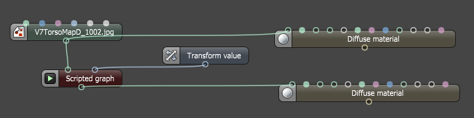

This is as close as I get. Have made code that creates the connections for texture and transform input and texture output but cant figure out how to write the code that actually does something.
