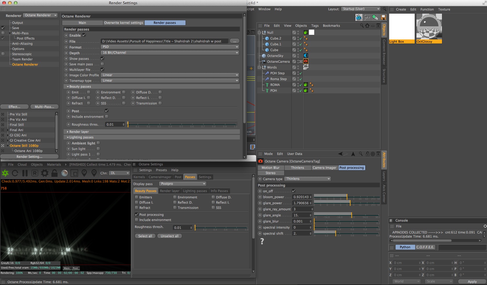

I can get the post effect glare to show up when I have an alpha going in the live view, but when I render a final to picture viewer, the glare streaks don't seem to make it. I use the copy to video post command, and everything else carries over, but that one effect. What am I missing?

The alpha mask is cutting the effect, but you can activate in the multipass tab the post-effect as separate layer, so you can compose it later on.

Sorry, I must have been more specific.
Not the c4d multipass but the octane multipass:
try with this scene:
Shahidrah-b.c4d.zip
(89.03 KiB) Downloaded 360 times
ciao beppe

That works great. Thanks so much!
