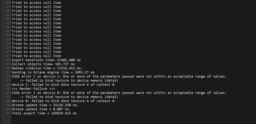

Hi Ahmet,
any idear, what this means?
Have "out of core" enabled and was hoping to get a hugh scene rendered.
thanks
Mike

where did this occured? In LV or PV? I see 22sec process time for materials, 12 sec. for mesh creation, 35 sec. for update. total 145 sec. Your scene should have huge amount of textures and objects. I don't have a exact idea what exceed limits but if you have out of core also have free vram, you should exceed triangle limits. But it points a texture error in Cuda error. I couldn't help so much for this. That's completely out of plugin and occurs in Cuda Renderer. You can try to delete/disable some parts of scene to understand what causes this.

it seams that polycount causes the problem.
Forgot about the poly-limit.
Will have to do 2 renders.
