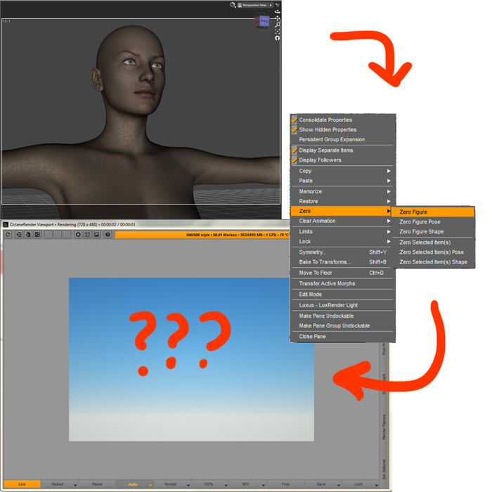

I'm using OCDS build 2.23, has this happened to any of you? Hitting "Zero Figure" makes a figure disappear from OCDS viewport. Same thing with "Zero Selected Item(s)", it causes the selected item(s) to disappear from OCDS viewport. I've prepared two screenshots using V6 to show what I mean. - tested with G1, G2F, G3 and Cybermech 4, they all exhibit the same problems.
In this example using V6, I select her neck and left shoulder. Zeroing the selected items renders them invisible in OCDS viewport.
In this second example, I select the V6 figure and hit "Zero Figure". In DS viewport she reverts back to G2F, but presto!! She disappears from OCDS viewport!

don't use zero figure.
Use zero shape.
Then zero pose. Or vice versa. Don't zero figure all at once.

Thanks, the two-step process works. :) A minor nuisance, but I'll take it if it gets the job done.
