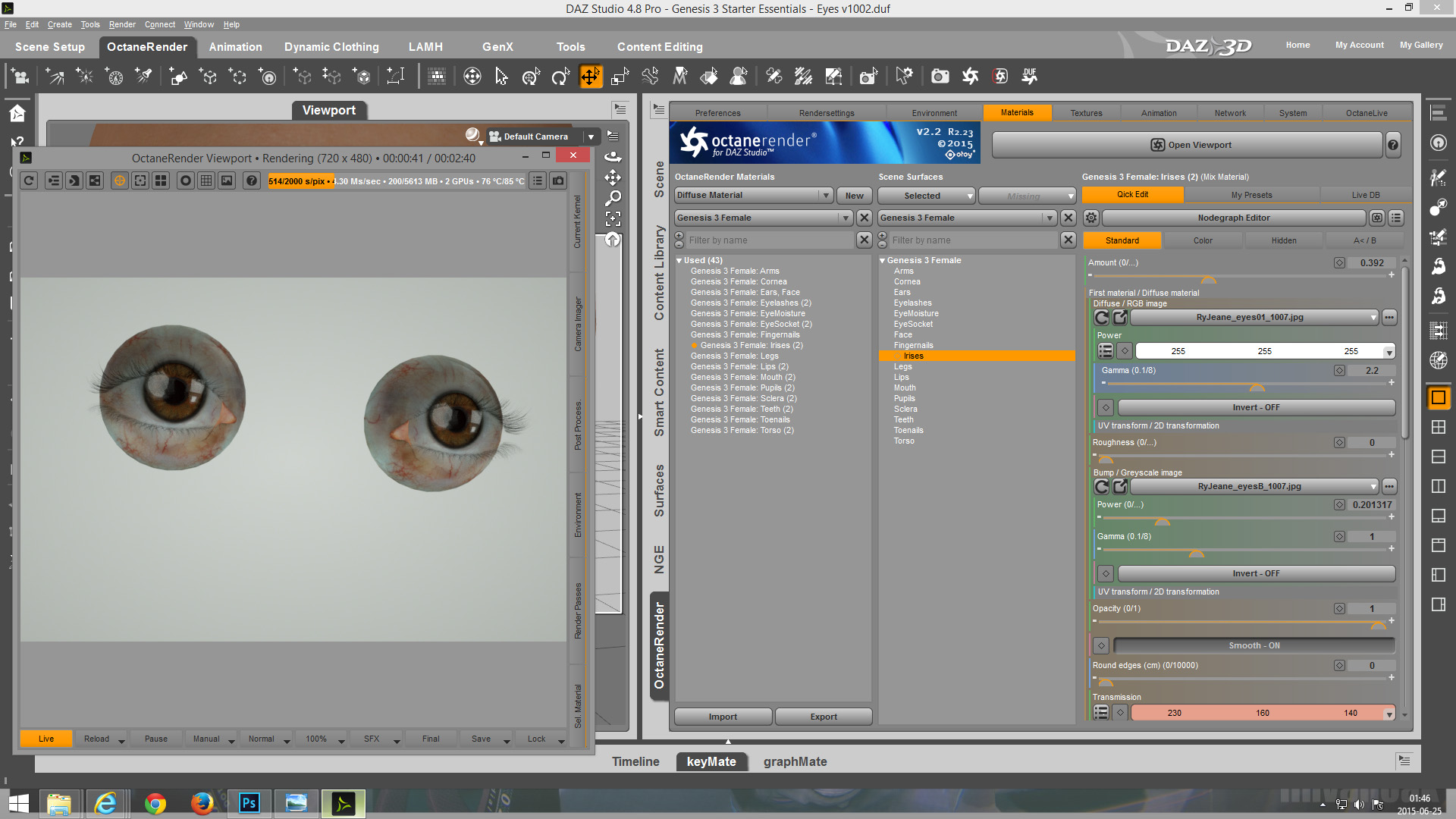

A closer look at the eyes:
In the Genesis 2 Generation the eye surface zone offered a huge improvement over the original Genesis generation.
Let's have a closer look how the eyes now work with Genesis 3.
Cornea:
By default the Cornea loades with Opacity set at zero.
It seems the Cornea is once again just a surface.
Nevertheless the way volumes work in Octane this means if we apply the live DB material "clear cornea" to the Cornea surface zone a volume is created with the Irises as inner border.

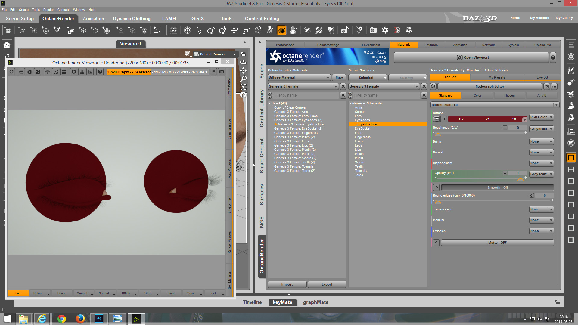

Eyesocket:
The most interesting addition is the Eyesocket.
Not really sure what the original intention is.
Did anyone find a forum post about it allready?
The eyesocket is smaller as the eye shape created by the Sclera.
Further experiments:
In theory for OctaneRender that now could mean that a volume is created between Irises (front), Eyesocket (back) and Sclera (side).
It would be interesting to observe what happens if we transform the Irises or the Sclera to a spherical material.
EyeMoisture:
The EyeMoisture seems to be similar as the former Eyereflection surface.
The surface seems to cover the whole Eye and seems to be in front of the Cornea and the Sclera.
Further Experiments:
It seems the EyeMoisture surface can be hidden in OctaneRender because no volumes seem to be created between the EyeMoisture surface (front) and the Cornea (front) and the EyeMoisture surface (side) and the Sclera (side).
Vicoria 7 uses a MoistureMap. I will test later how that could be put to some use in OctaneRender.
For renders that do not want to achieve photorealism the EyeMoisture surface can certainly be used for reflection maps.

- The EyeMoisture surface will load at full opacity. Set it to zero to make the underlying eye materials visible.

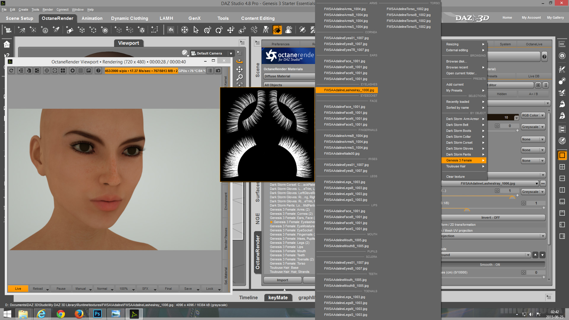

- Eyelashes
For two different characters the transparency map of the Eyelashes was not added in the autoconverted OcDS material.
Nevertheless the map shows up in the map overview list "by object" created by OcDS so you can add it manually.
Workaround to quickly find any maps the OcDS plugin detected:
It seems when the OcDS autoconverts either the 3Delight or the Iray shader setup a list of all available maps is created for each object.
It seems even if the 3Delight or Iray shader setup may not be fully supported all found maps are still listed even if they were not added in the OcDS Node Graph layout.
