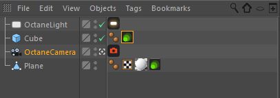

I've added an octane object tag to the cube and the floor, both on object layer 1.
Objects in scene
Objects in scene

I tried object ID 1 and 2 with the same results(cube and floor tags). I still see a white screen...
I have reloaded the scene as well, resending to octane with no change.
