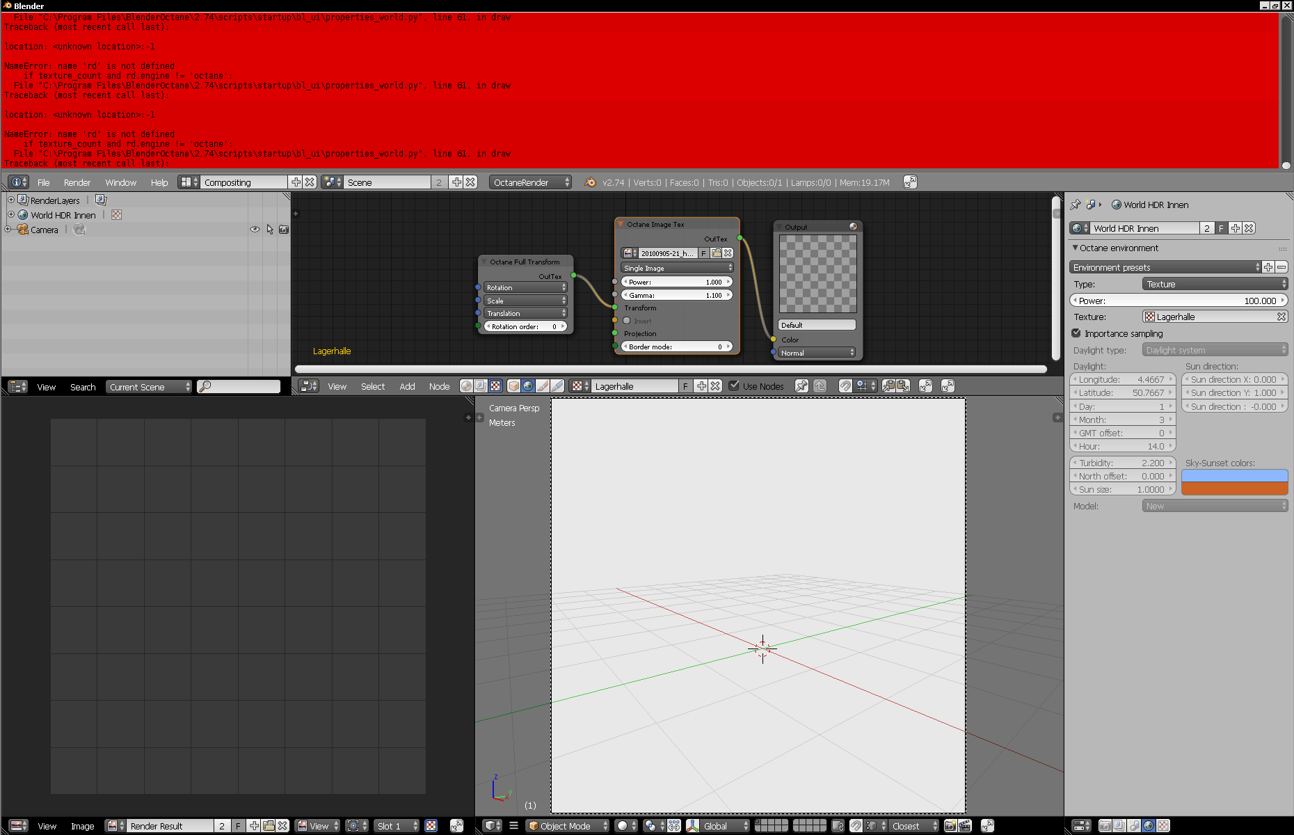

by aufwind
When adding a texture to the world settings in the node editor
I get a script error.
HDR background is rendering without any problem though
