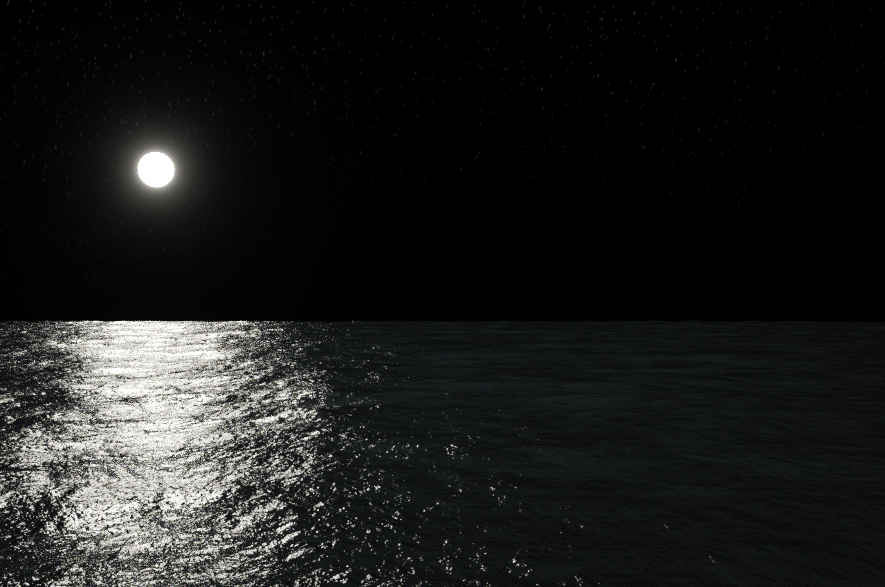

Next project I'm working on is a night time ocean scene. I'm trying to figure out how to get that hazy look on the horizon, but I can't get something decent. I've been playing with a cube parented to the camera with inverted normals and a specular scattering medium applied to that. The fog effect is either way too intense almost like pea-soup, or its nonexistent. I can't get a happy medium, or define an area where the fog should start. It also ends up blanking out my night sky which has a texture of stars on an Octane Sky object (a separate issue I'm not sure how to fix).
Here's a reference image of what i'm trying to accomplish. Look at the horizon and notice the falloff of the haze. I'm trying to get that effect.
Any ideas?

What i've found out is that the Phase setting in the scattering node makes HUGE difference. Play around with that.
Also how high are your fog box? Don't make it too high. Just above your camera FOV. And your stars will shine.
Assume your camera bubble has inverted normals. Else things fuck up.
Also play with fog materials opacity setting. Float value or gradient texture.

No need to make the fog box smaller. Think on big sizes of objects. Decrease the scale of medium, it's a multiplier. And use a daylight+mix with star environment texture with high power of images as 10-50. See what's happening.

Here's my scene file for anyone to take a look at. I got a little closer with using a gradient in the opacity channel, but then when I look up, I see a weird projection of the fog on other faces of the bubble. Also can't seem to smooth out the transition of the moon's reflection with fog. It still looks really sharp.
Am I going about this the right way? Or should I be creating my stars, moon, and clouds in one large HDRI and putting that in the OctaneSky Object?

see the image what i have achieved via a fog box. It's illuminated by a hdr image

Is your scene just really really large? Are you using the camera bubble technique or are you encompassing the entire scene in one large fog volume?
