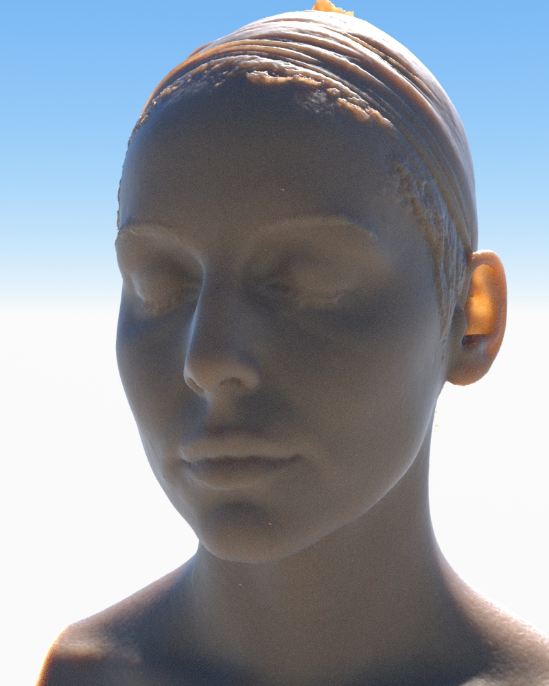

So I´ve tried getting the material to look decent without the textures, but with no luck....this is my result.
I´ve done nothing but turn up the scale as you suggested, but I can´t figure out how to get rid of this brownish-dirty look. This stays that way when I plug in the texture maps by the way.

edit - I just saw your edit, so I'm responding to that here. I had similar issues when beginning to play with Tonysculptor's textures, of the skin looking too dark. I'm going to have to wait til Monday to get on my work computer to get back to you with specifics, but here are a couple of things that come to mind - is your kernel set to Path Tracing (or PMC)? In the Direct kernel, specular materials such as in tonysculptor's skin don't work right, so make sure it's not on Direct. And also, try playing with the gamma setting on your skin color map. Lowering it from 2.2 to 1 might help correct the problem. Make sure that "Fake Shadows" is checked on in the specular material. And like I mentioned earlier, it will make your experimenting easier if you first manage to get Tonysculptor skin looking good with its default RGB color before importing your own textures. Once you know that it works with a simple color for the skin, you're ready to introduce the variable of a texture image and troubleshooting that. I'll check in on ya tomorrow.

Wow, that did the trick! Thanks again for taking me throug it, I feel like I would never have managed to figure it out on my own...I´ve started looking into the NGE and it looks like I can learn a lot there.
Additionally I found what caused the brownish look: I accidentally changed the specular and diffuse depth of the pathtracing kernel, made the whole thing look like a mess.
