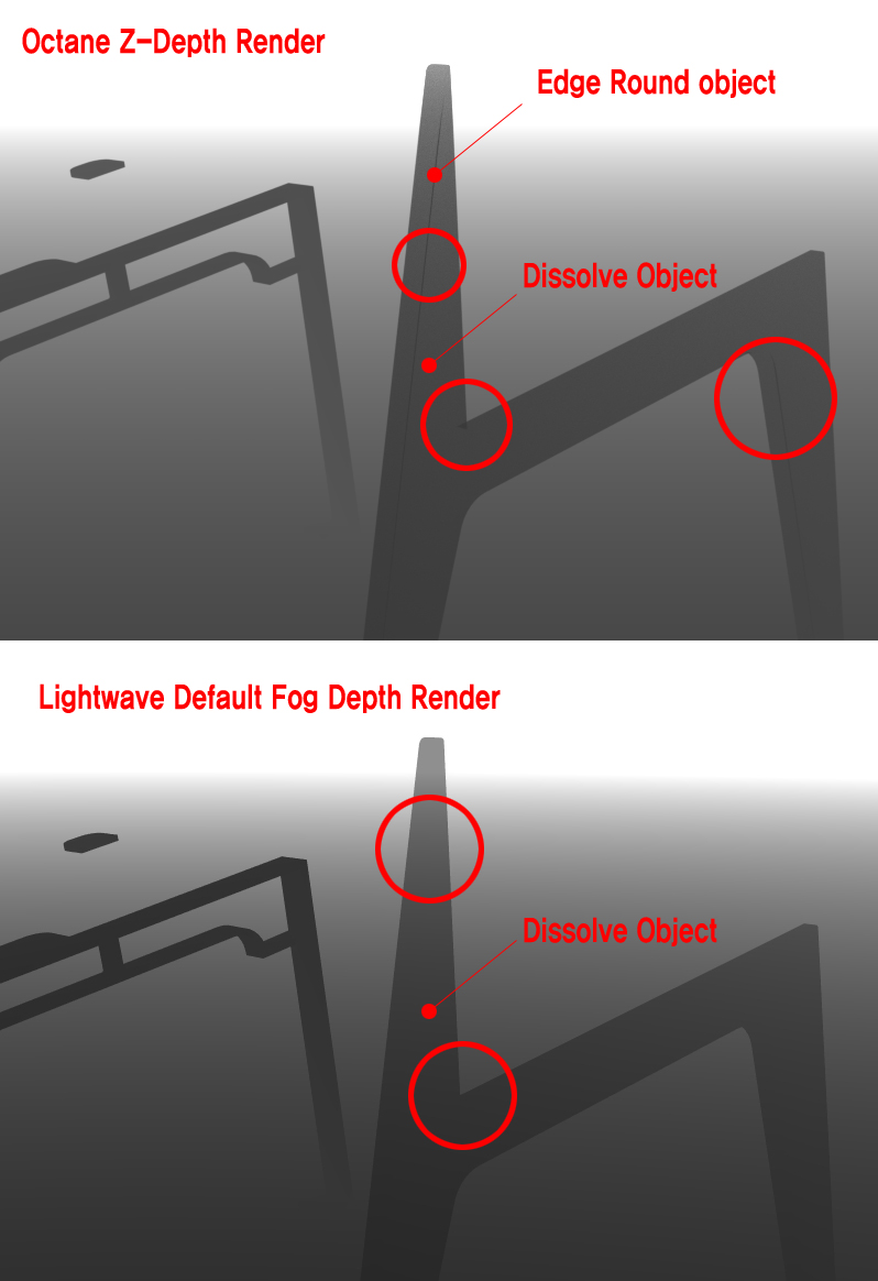

How to create a basic rendering Fog Render like ??

Can you send to me this object to test it here? ... it has a weird artifact in the Octane Z-Depth render. Perhaps the model has a problem, or there is a bug in Octane.

I may be on totally wrong path with this but just came to my mind from my experience (and manual) that Octane does not like other than Tris and Quads. I had some very strange results when I had a cylinder that had not been Poled. Try to Triple the object and then try again :)

If you have LWCad then "Make Quad" or "Make Convex" will fix those problems.
Otherwise, go with what Antti said.

I think that this is not the scene with your problem. Please check it ;)

The problem is the dissolve effect in the object. Dissolve in Octane works with the opacity channel of the materials, so I think that it doesn't have the same behavior than in LW. You are making the object transparent, and the Z buffer has wrong data from the polygons inside the object
Anyway a Z buffer in a transparent object has no sense (this is not the real distance to the object surface), and at least for a fog effect I think that you should disable the dissolve feature. In this pass render all the objects without transparency or dissolve effects.
