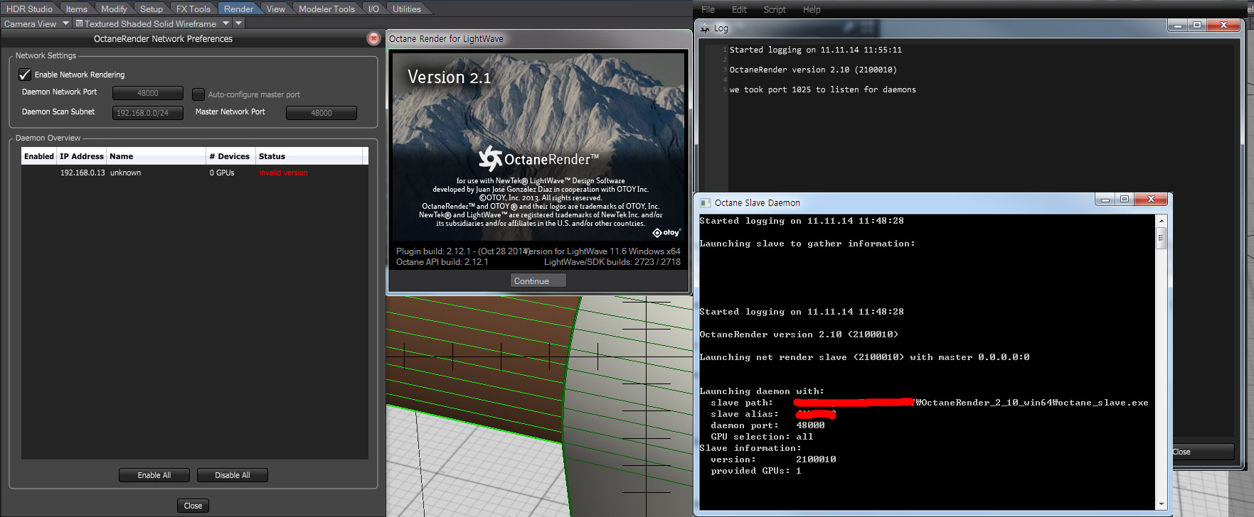

Re: Object Dissolve problem
Posted: Tue Nov 11, 2014 2:22 am
by jang2235
Where is the last standalone version?
The Network rendering error. Octane slave Daemon message is "master daemon daemon message invalid version" I get called.
Plugin build 2.121
OctaneRender version 2.10(1200010) download
