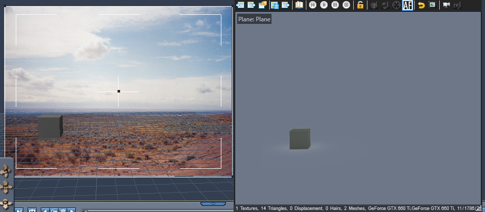

Sorry, had to remove the link as it was part of the closed testing forum, these images should point you in the right direction though..
If you still need help then just ask ;)
shader/Lighting models/Shadow catcher
Enable Alpha Channel in Render Target settings..
Use DIFFUSE and make sure MATTE is selected ;)
Backdrop (not currently supported in OR4C), you will need to do some comp work..
BD2
BD2
COMP both render & background in another program/video editor..
You should then be able to composite your render & background in another program or video editor ;)
