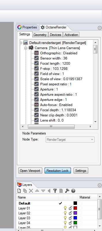

Hi Paul-
Running into a bug that I haven't found mentioned elsewhere. Apologies if this has been covered already.
The Octane toolbar doesn't show the materials panel for me. I'm running Rhino 5 x64 SR11. I've tried a few different versions of the plugin, both the 2.22.2 stable and the latest test version. Suggestions?
See attached image.
Thanks,
Matt
mswaidan
Posts: 5
Joined: Tue Jan 04, 2011 8:48 pm
Also just tried rolling back to SR10, still having the same issue.
face_off
Posts: 15811
Location: Adelaide, Australia
Hi Matt
The Material panel is integrated into the Rhino Material panel. http://render.otoy.com/manuals/Rhino/?page_id=35
Paul
