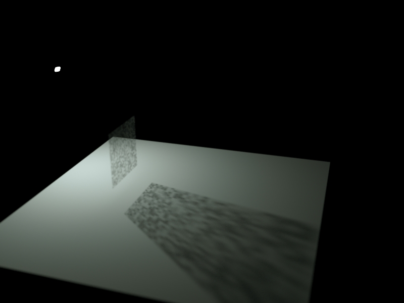

be sure to turn on "alphashadow" in PMC kernel
made a short test. diffuse material with mosaic opacity texture.
cheers
boris
edit: works also with direct light and path tracing

here a single sided specular material, index=1.0, map in transmission port and fake shadows on (option in specular material).
