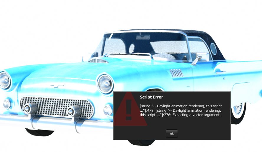

Thanks for sharing. Interesting I got this vector error issue.
Day Light script error
Re: Daylight animations in Lua
Posted: Tue Dec 31, 2013 7:33 am
by stratified
My mistake, setAnimator expects a list of vectors in 1.23, we relaxed this in 1.24.
I've update the initial post, it should work now.
