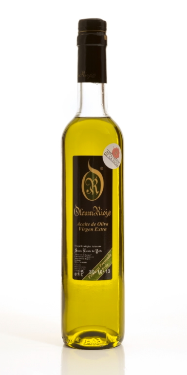

Status
So I sent the pic to my wager partner and also to another professional photographer (actually my brother in law - since we are no fans of each other, I can be sure he criticizes me, when he got a point).
wager partner: "Wow, I am impressed - still look at my still shots..."
photographer #2: "...looks dead, me not likes"
Turns out my wager partner had his light all tuned up, so basically the scene around the bottle is almost white on his shots. Basically we misunderstood each other and I will see to get into his work - again.
So here is his work and my new "target":
