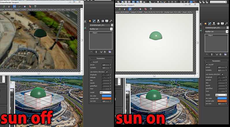

Jum, thanks a lot! BUt, found out.. when i turn the sun ON it disappears.. octane light is ok, but the sun "removes" the background.
thats a bug or what??

Let me explain better.. i wanna do this.. (i did in mental ray.. but dont know how to do in octane)..
the background as a picture and this ball rendered and the floor as matte shadow (shadow catcher).
Is this possible!??

Octane sun + environment map working together is not supported. You should use octane light+envrionment map instead of sun+env.map.
Another way, draw a hemishpere and put the panaromic envrionment map on it and add octane sun. So you can get closer effect to sun light + environment image.
