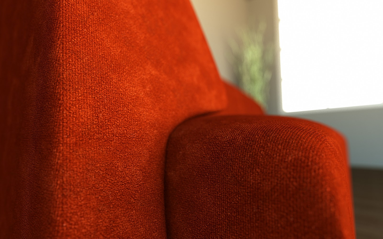

I have tried for some time to get a realistic looking fabric and or leather, but can not. I can get a slight fabric pattern on the surface but nothing like below links. I am missing the deep feeling of a fabric.

.. try normal maps insted of simple b&w bump =) You can generate those with some programs like nDo2.
falloff property in reflection or even in diffuse slots are also nesecary to get good looking of some fabric materials.

you need to map those textures, those materials you did are pretty much ok
- also you need to configure the size of the texture according to the camera view - the farther you go the textures look like they have no bumps and so on..
I made this one with bump maps - and adjusted the standard cube mapping until it appeared like it had natural seams, on this one the bump texture (didn't use normal maps) was different than the diffuse texture
