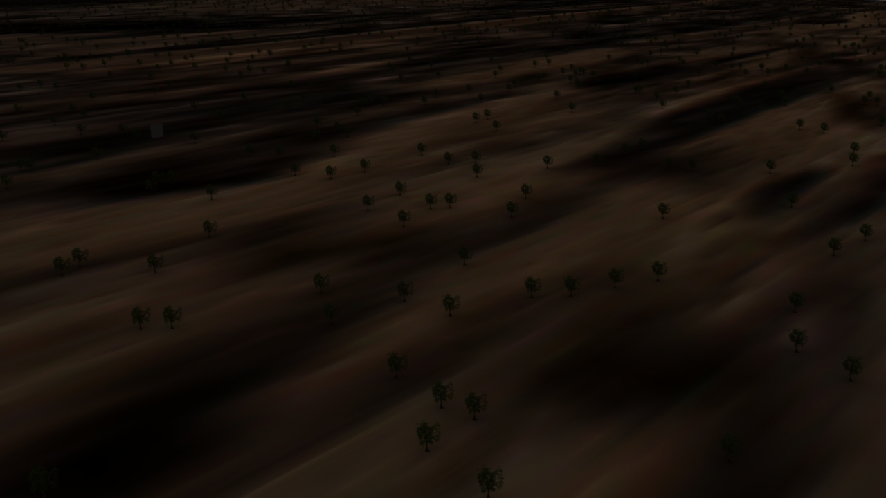

OK, here is some more info on the issues I reported a couple of posts back.
TBFX wrote:1. When the number of instances gets over about 8000 my ground plane picks up the wrong shader unless I also make it a movable proxy. (in my tree scene anyway) problem is this also seems to affect my octane light.
Here are some pics to illustrate this. JimStar, these are done with the scene I sent you so they will be easy enough for you to replicate. Just scale the ground plane by a factor of 100 before you start emission to give the scene more room, set the env to texture instead of daylight and lower it's texture slider to about 0.4 then add an octane light like you see in the images below.
As you can see everything reacts as expected up to nearly 8000 instances then once I go over that the ground picks up the wrong shader and the light goes off. Then if I make the ground and light movable proxies the correct shaders come back but of course my light is then dim due to the issue we are already aware of.
TBFX wrote:2. If I have multiple trees in the instance node octane is only picking one to render even though the bounding boxes are different sizes which indicates that maya is distributing them in the particle system as expected. I need to do some more investigation on this one as simple objects like a sphere, cube and cone still work as expected but I ran out of time today.
I've tested this thoroughly now in various scenes with different geometry and tracked it down. Everything works fine if the multiple objects instanced to the particle system are not movable proxies but if they are Octane is only getting the first one and using it for all others.
I have also had some old scenes fail to start rendering in this version only in the interface not in batch mode(though they would no doubt fail there too) but they were very old and not ones saved with the 3.xx branch installed. Will check them out and send crash dumps if I get the chance.
T.
