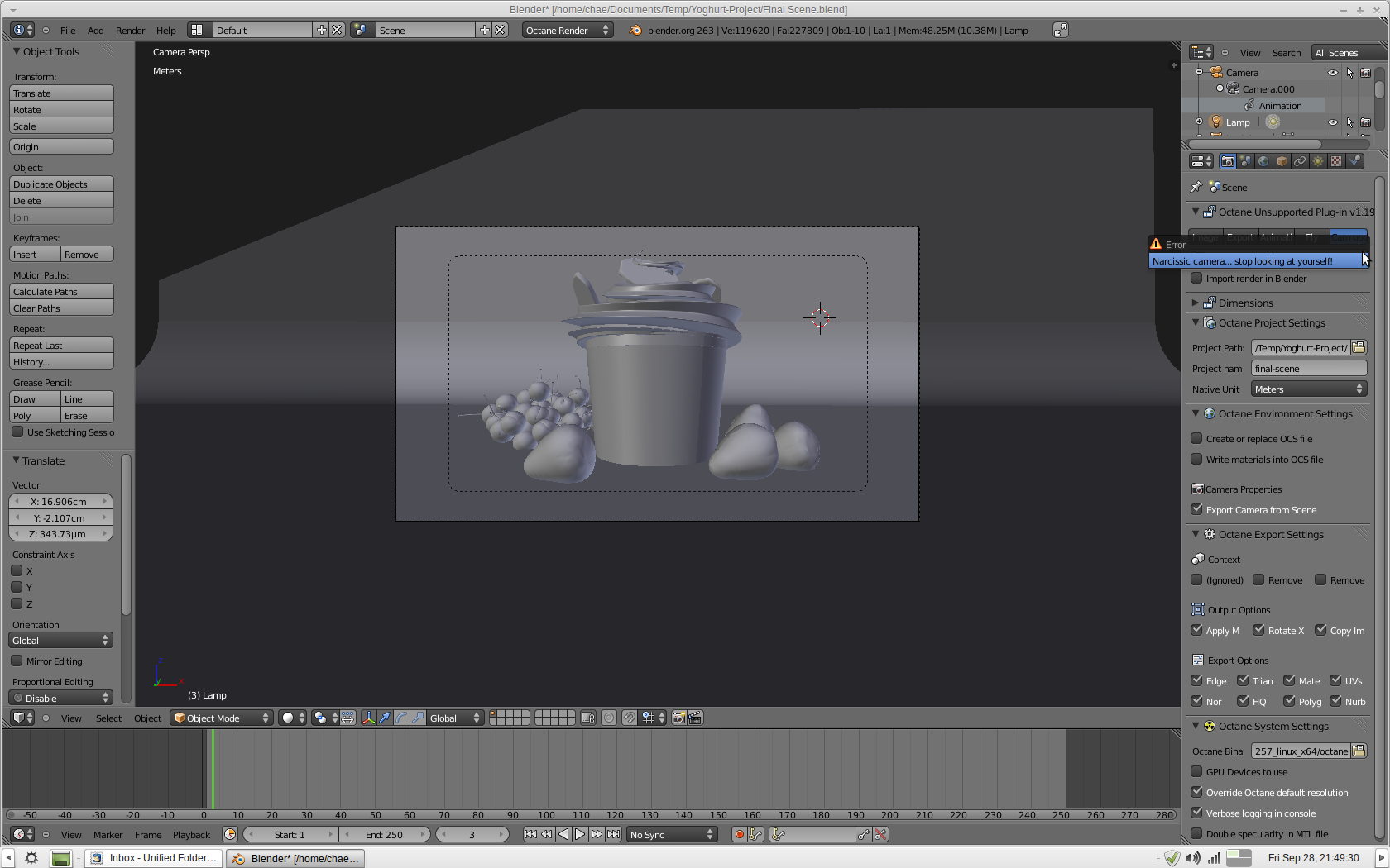

I then set up a basic camera, click render & now I'm getting an error "Narcissic Camera Stop Looking At Yourself" even though the camera view shows what I want ?
I untick the export to camera option from Octane's settings & off it goes, opens up Octane but as above still can't find my model

Narcissic Camera Screen Dump...
I can render the camera view with the normal blender render command with no errors, as soon as I do Octance render error message.
Re: Frustrated Again
Posted: Fri Sep 28, 2012 10:38 am
by matej
You have the camera object set as the camera focus object, so it's focusing on itself. :)
