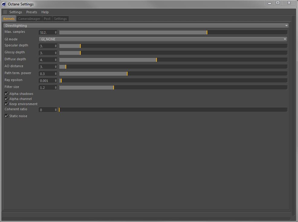

yes. for picture viewer rendering it works fine. i'm looking for the LiveViewer Render Passes Settings...
Re: Version 2.25-R3 (18.02.2016) - Current Stable
Posted: Mon Mar 21, 2016 7:34 pm
by momade
Sorry aoktar.
I guess I have an issue here. Mayebe you can help...
I uninstalled EVERYTHING that had to do with otoy or octane to make a clean cut.
reinstalled the c4d plugin und it works without SDK...
here is a console screenshot:
there are NO files in any OTOY folder on my system. still octane for c4d works alone and i still have no render passes option in LiveViewer:
