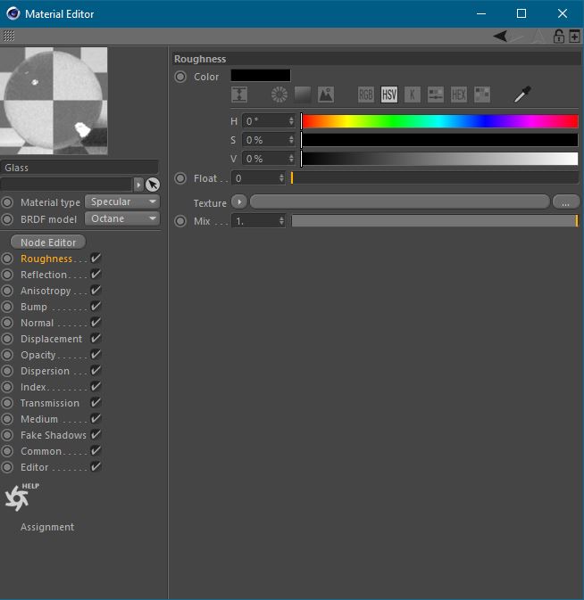

Hi Guys,
Is it just me or is the film attribute missing from the specular material?
Missing in C4D
Present in SA
Is this a bug?
Re: Cinema 4D version 2018.1-R3(Latest stable) - 29.03.2019
Posted: Wed Apr 03, 2019 1:04 pm
by aoktar
leehenshall wrote:Hi Guys,
Missing in C4D
Present in SA
Is this a bug?
Looks like I overlooked to display this part for specular material. I'll fix for next build. As a workaround set it with glossy type and switch to specular.
Posted: Wed Apr 03, 2019 1:16 pm
by leehenshall
Thanks for confirming aoktar
I'll use the work around for now.
Thanks :)
