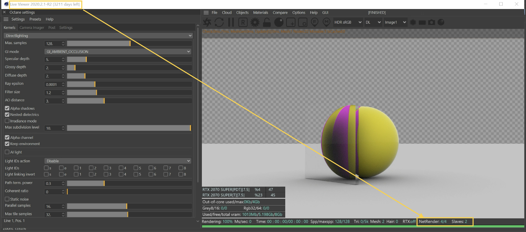

I have an invalid version message with my network nodes with plugin R2.
viewtopic.php?f=85&t=77169
viewtopic.php?f=24&t=77111
Plugin and nodes not matching for me.
Only on my side ?
thanks
Re: Cinema4D version 2020.2.1-R2 (Latest stable) 17.03.2021
Posted: Fri Mar 19, 2021 9:24 am
by bepeg4d
please press SHIFT+F10 and share a screenshot:
Net render is working as expected here with 2020.2.1-R2.
Looking forward for your feedback,
ciao Beppe
Posted: Fri Mar 19, 2021 9:34 am
by pxlntwrk
bepeg4d wrote:Hi,
ciao Beppe
Apologies for the inconvenience, it's all my fault, I got stuck in the versions :shock: .
There are days like that :cry:
Thank you, Beppe, for pointing me in the right direction.
Cheers
