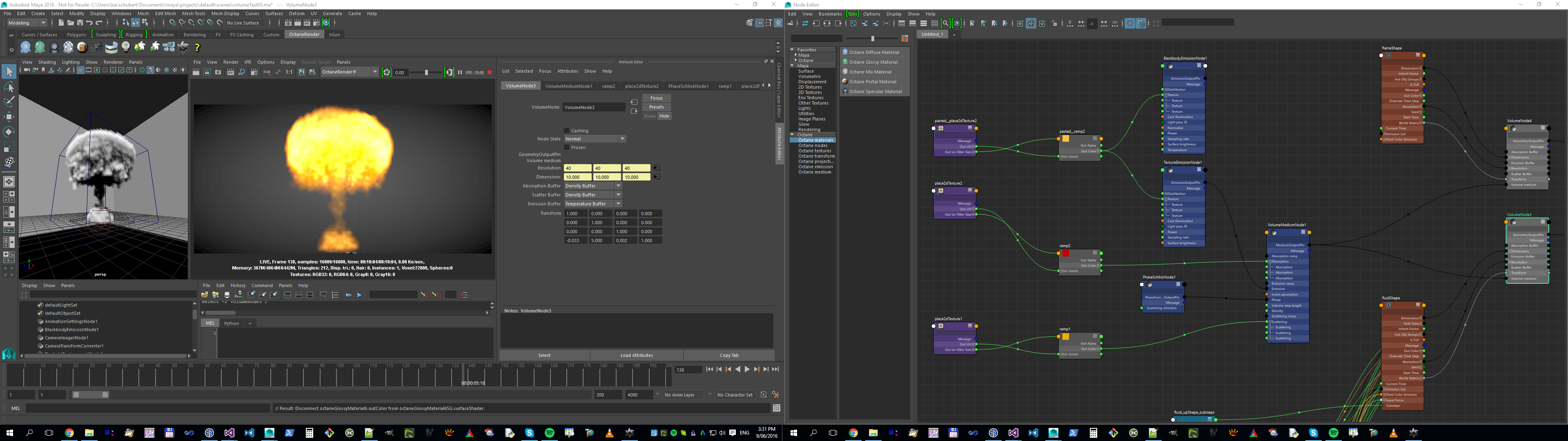

Posted: Thu Jun 09, 2016 3:50 am
by k.a.schubert
Update Post
limeforce wrote:Keep fighting the good fight! Whenever it feels like you're drowning in the Maya API remember that the fruits of your labor will make a lot of people happy!
Everyday!
And it makes me happy more and more as well!
Just sometimes with the Maya API or support I am like :
:D
With the updates Calus suggested for using the world matrix of shape nodes to transform them to their place in the world (byebye transform nodes ;) ),
the volumes grew upstream, already giving some nicish results:
Still need to implement the internal ramp attributes (absorption, scatter, emission), but then volumes should be done for now. :)
I'll continue with fixing stuff in the old system (or redoing it), that broke along the way, like batch rendering, which crashes me right now.
And things related to the attribute editor, like the color picker not showing up anymore for float3 attributes.
Gotta override that "AE***Template" for all new nodes like Jimstar did, I guess. Yay....MEL....not
Best,
Kai
