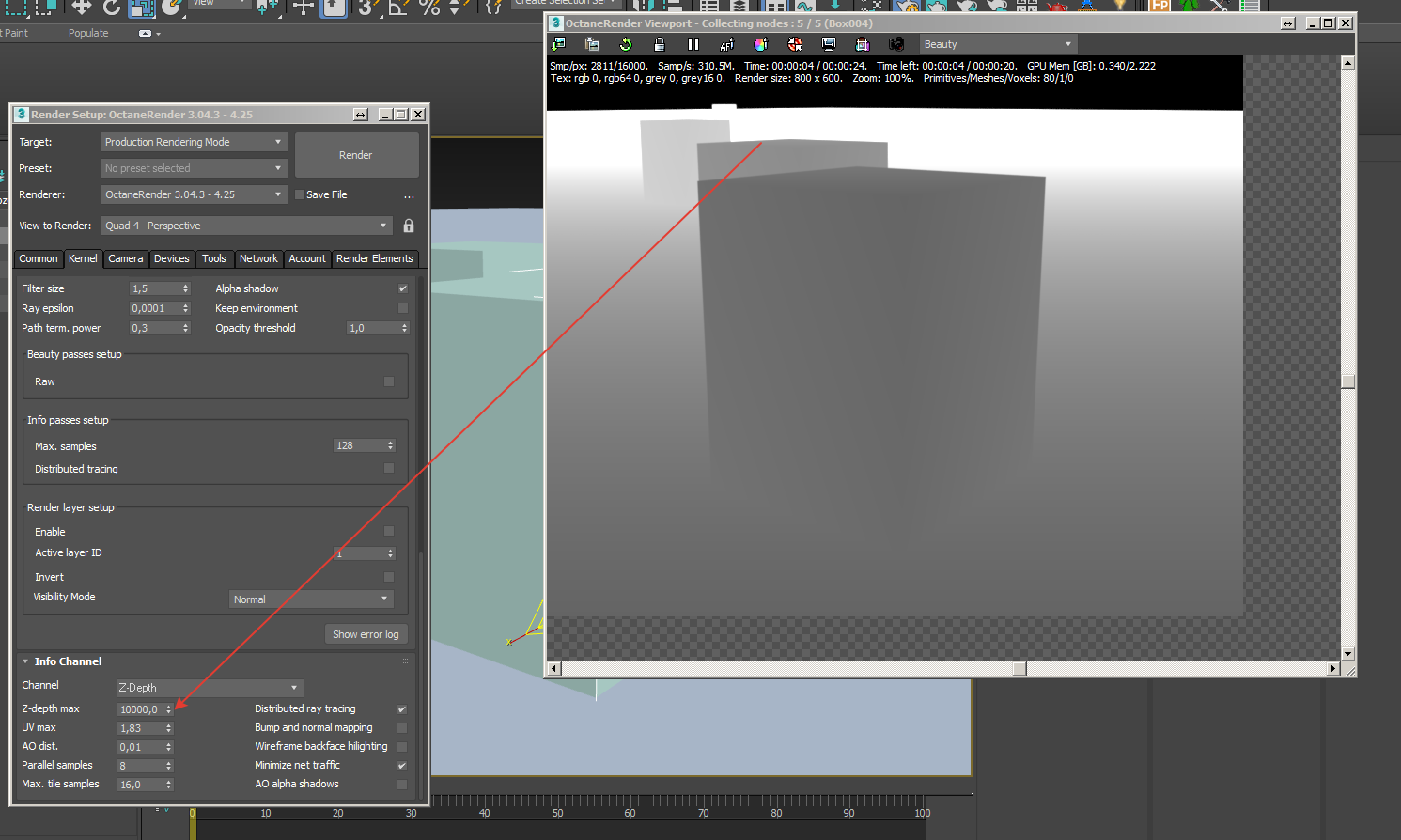

sorry I work at 4, 25 -- can't test at 4.26
what that position fails and it stops working post the scene
maybe this picture will help you
..... I think I understand .... somewhere should be a button to tweak the setting a Z-depth but I know two versions is in the info channel and in the render elements ... but I can't change the depth to make it more advanced
I really want the Z-depth max-what do I measure ? let's be tied to the values of scene - mm - cm - m - - - and then some incomprehensible value than to measure I do not understand

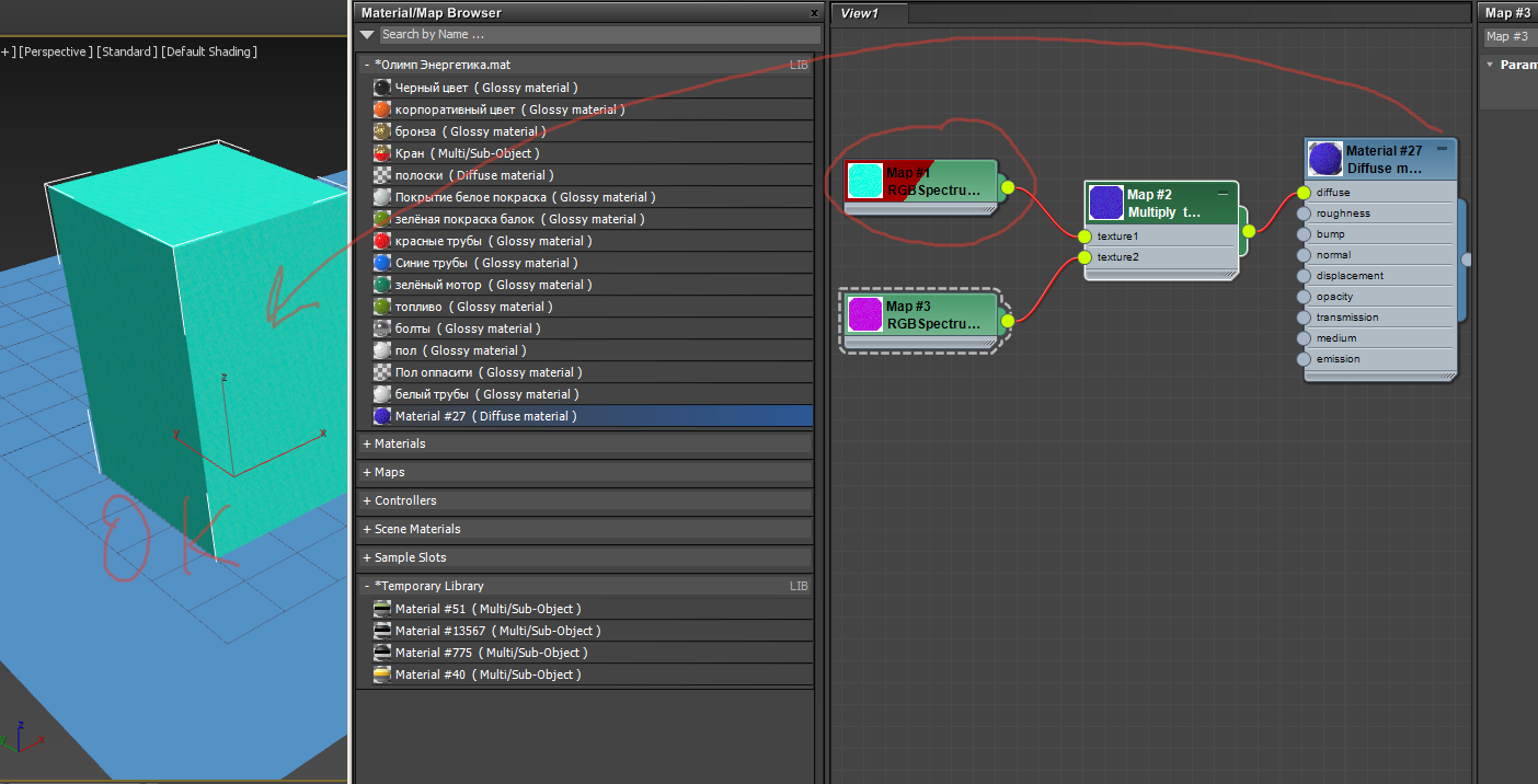

perhaps it is a feature of 3Dmax but I lose the color ... maybe as an option to make the button update the viewport on the texture and colors
this script updates the texture but does not update the color
showOctaneDiffuseMap.rar
(452 Bytes) Downloaded 270 times
I 3D max there is a function but it is not used in octane
