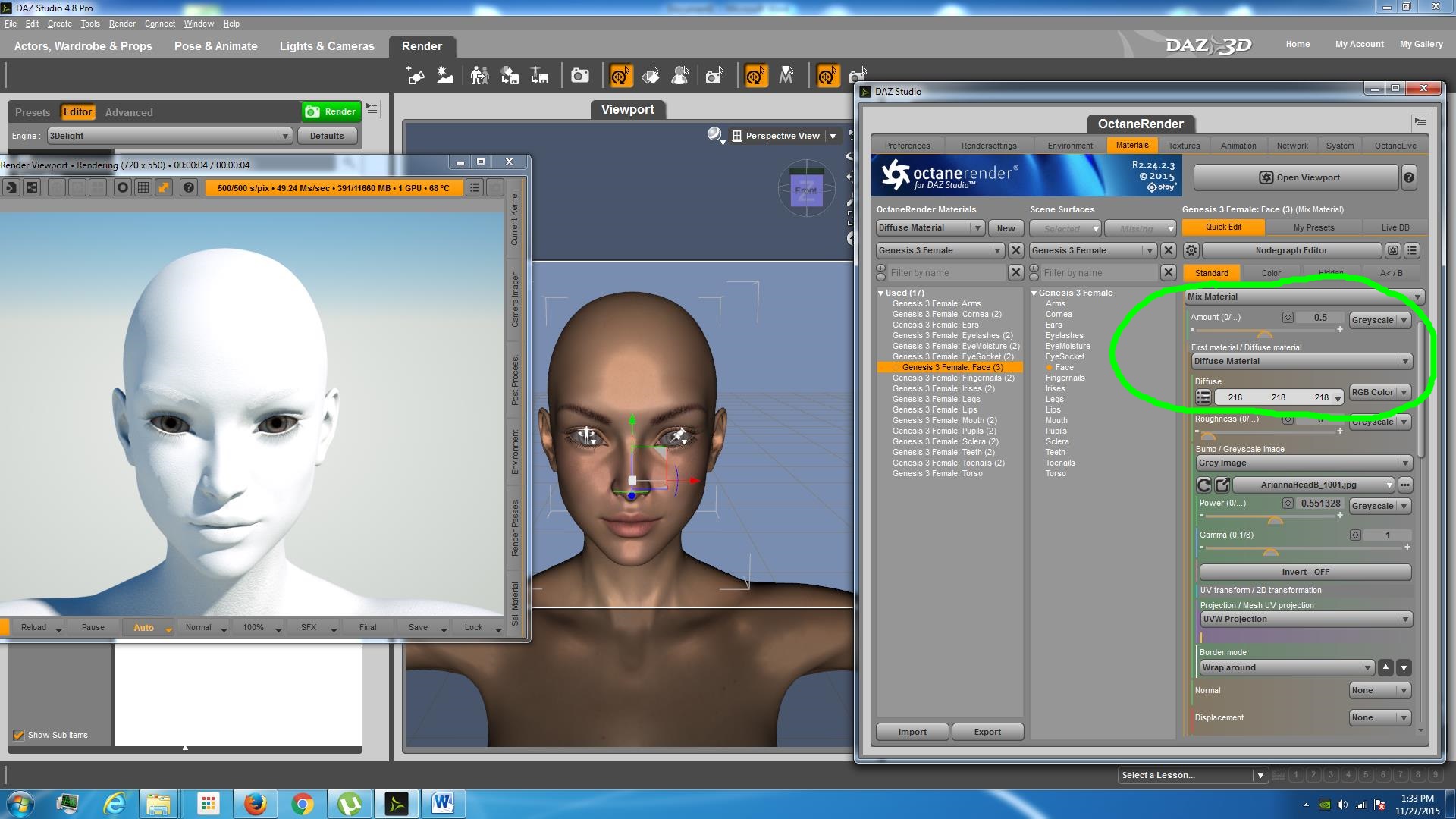

Just an update on the new-problem with Iray mats and the white characters, like Arianna
Here is how to render properly as a workaround (may be of use to resolving bug also)
Using the Face material:
Comes into OcDS as a Mixed Material with Diffuse having 'RGB Color' of White
Change Mixed Material header to Diffuse, then change 'RGB Color' to 'RGB Image' and load an image
Using this method it doesn't appear you need to tweak anything else, such as amount, power, etc.

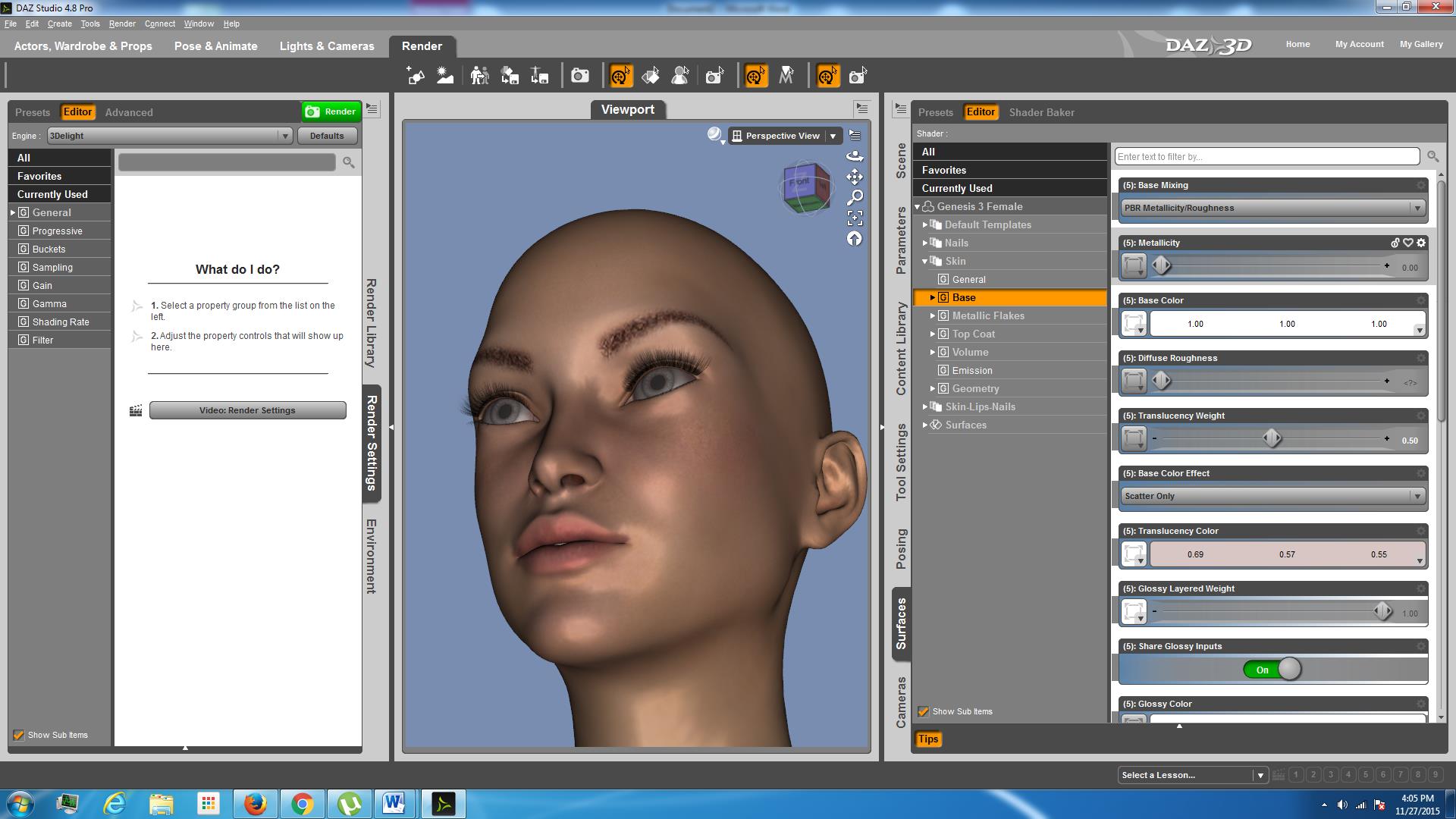

1 of 11 - General
1 of 11 - General
2 of 11 - Base 1
2 of 11 - Base 1
3 of 11 - Base 2
3 of 11 - Base 2
4 of 11 - Base 3
4 of 11 - Base 3
5 of 11 - Metallic Flakes
6 of 11 - Top Coat 1
7 of 11 - Top Coat 2
8 of 11 - Volume
8 of 11 - Volume
9 of 11 - Emission
9 of 11 - Emission
10 of 11 - Geometry 1
11 of 11 - Geometry 2
Let me know what else we need, thanks!

Can you pls post screenshots of all the variables in the Surfaces->Skin panel for Arianna - and I will find out why the material conversion is not working.
That's for posting those screenshots. I was actual after any one of the Surfaces->skin materials. In particular - I need to see the Property which contains the diffuse map. My apologies for not being more specific.
Paul
Re: Materials Conversion - Current Issues and Requests
Posted: Sat Nov 28, 2015 1:49 am
by Notiusweb
LOL :D
Here are the 2 instances of a map in Diffuse for the Arianna face material...The Base Color map does not go over to OcDS, if it did it would render properly.
Diffuse Selection
Diffuse Selection
Base Color Map
Base Color Map
Translucency Color Map
Let me know if we need anything else, thanks!

And Paul, look at this, it (G3F Arianna's face material) comes over in OcDS under the Mixed Material header, with 2 instances of a Diffuse Material..this is how you fix it, keeping it as a Mixed Material
Instance #1
Instance #2

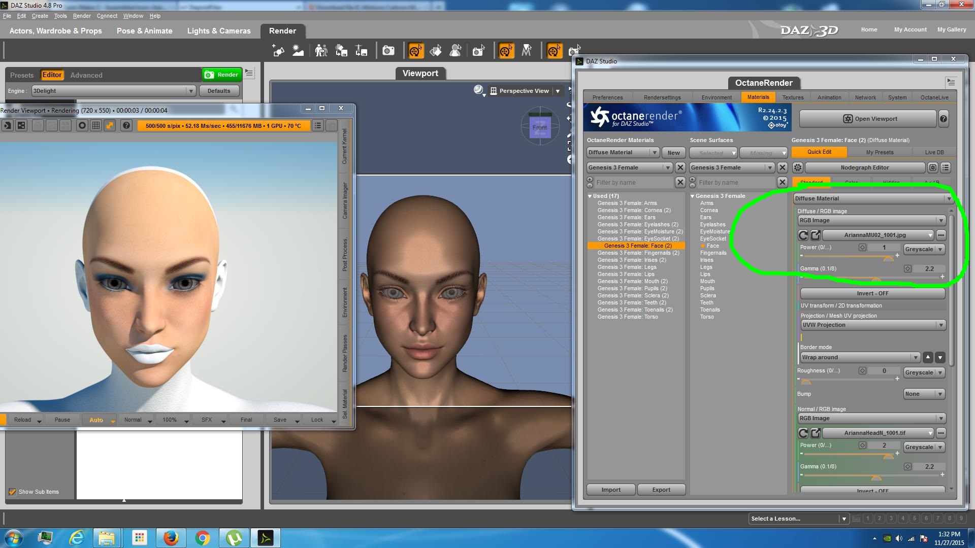

So to fix in OcDS, keeping the Mixed Material header, you have to load the image in both Diffuse Mat instances:
Here is me changing 'RGB Color' to 'RGB Image' and loading image into just the 1st instance...yields a 50% rendered face map
Here is me then also changing 'RGB Color' to 'RGB Image' and loading image into the 2nd instance too...properly rendered face map
Now, if you change the master header from a Mixed Material to a single Diffuse ("Diffuse" in the drop-down), it gives you only one Diffuse instance, so you only had to load it once.
Master Header to a single Diffuse, only need to change 'RGB Color' to 'RGB Image' and load image in the one instance
So a fix could work either way, depending on if you keep it as a mixed material, or switch it to a single diffuse.
