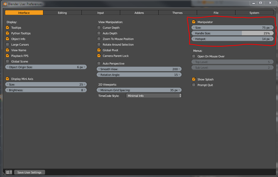

Anyone knows why I have a gigantic xyz axis widget?
It's the first time it happens in blender, it's on all the views, it's only the blender-octane and there doesn't seem to be way to scale it down, is there?
Re: OctaneRender™ for Blender 1.30 - 3.2 beta Win [CURRENT]
Posted: Wed Feb 19, 2014 8:31 am
by voon
vimaxus wrote:Anyone knows why I have a gigantic xyz axis widget?
No idea ... but it can be changed: options->interface and then upper right corner, Manipulator settings (size etc). maybe there's a key command or something that you accidentally hit to scale it up, I don't know :)

Thank you so much!
I searched and I tried and couldn't find anything. I should have seen it... :oops:

Here for the size of manipulator :
Matt[/color]

I noticed this happened recently, where files saved with an older version are opened in latest blender (not just Octane Blender). It occurs over different versions and started for me using builds since 269 release. As above, I just changed size in settings.
Interestingly, there are also some issues in blender with angles on things like bevel modifier an lamps. Old files open up and where it was saved as 30 degrees, its changed to 1.79 degrees or some small value like that. I think they recently changed something to do with Radians / Degrees through blender, seems like an effect of that.

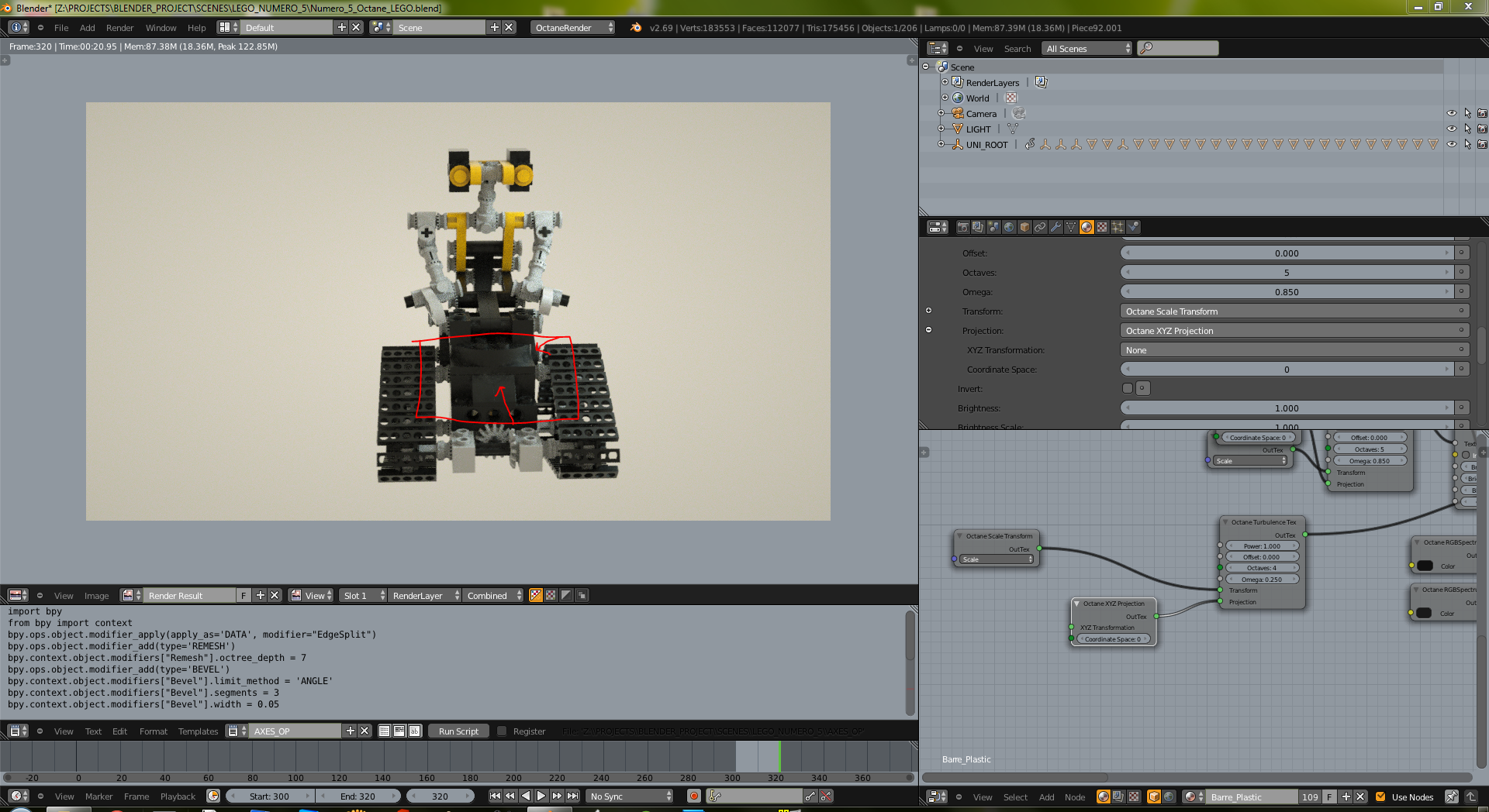

An other issue,
The turbulent texture or others procedural, not follows the model, that follows in standalone version without projection or uv ( Octane Standalone 1.31).
The texture just slides on the model in all ways, with or whitout uv, with or without projection. in the picture below, the texture that slides is show by the arrows, and the graph for the shader is on below right.
Hope will be fix quickly like the others little bugs ;)
I'm locked due this problem.
Thanks,
Matt[/color]
