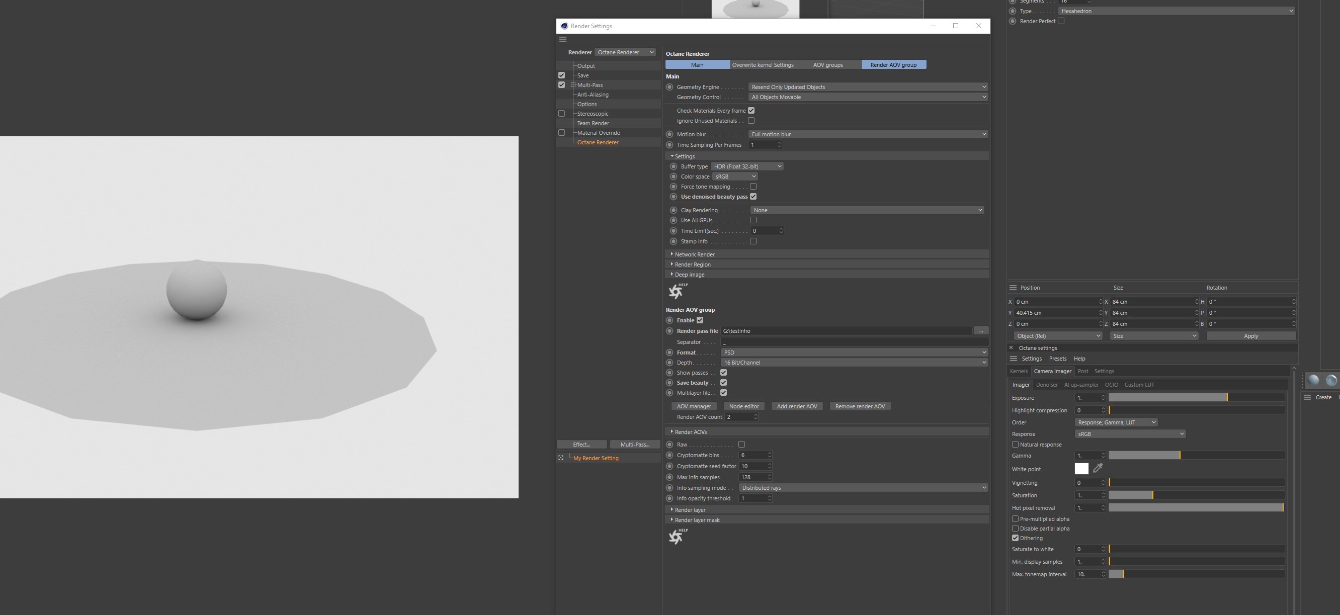

by marcus1070
Denoised Beauty are not being outputed on the render passes.. Denoiser active, save beauty.. you can see the denoised result on the picture viewer, but the file on photoshop is the standart beauty
CFG:
PS:

Re: Cinema4D version 2021.1 RC2 (Current 2021.1) 17.09.2021
Posted: Mon Sep 27, 2021 1:09 pm
by miohn
marcus1070 wrote:Denoised Beauty are not being outputed on the render passes.. Denoiser active, save beauty.. you can see the denoised result on the picture viewer, but the file on photoshop is the standart beauty
CFG:
PS:
the Light-Pass "Sun" not outputted as well!
regards
