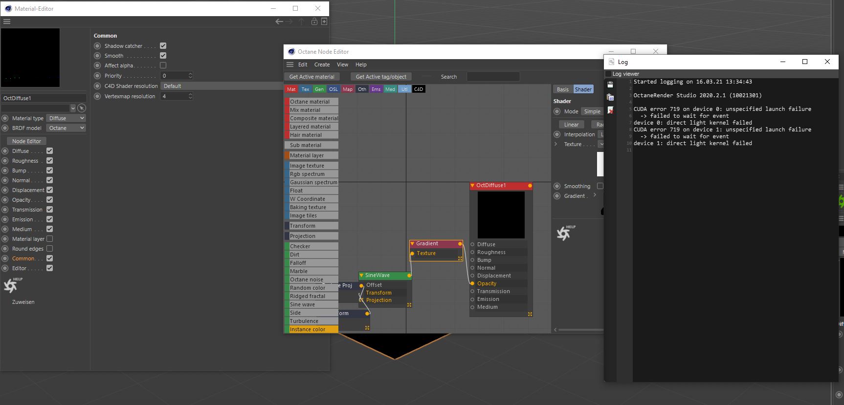

				by Kalua
				Hi, Aoktar
I was playing with shaders and diffuse, Octane crashed after activating "Shadow catcher". Please refer to LOG and image.
Regards,
				Re: Cinema4D version 2020.2.1 (Latest stable) 09.03.2021
				Posted: Tue Mar 16, 2021 12:43 pm
				by hazenkind
				Same here, if Material has a gradient in opacity channel --> activate shadow catcher --> crash
But except of this, good job Aoktar!
