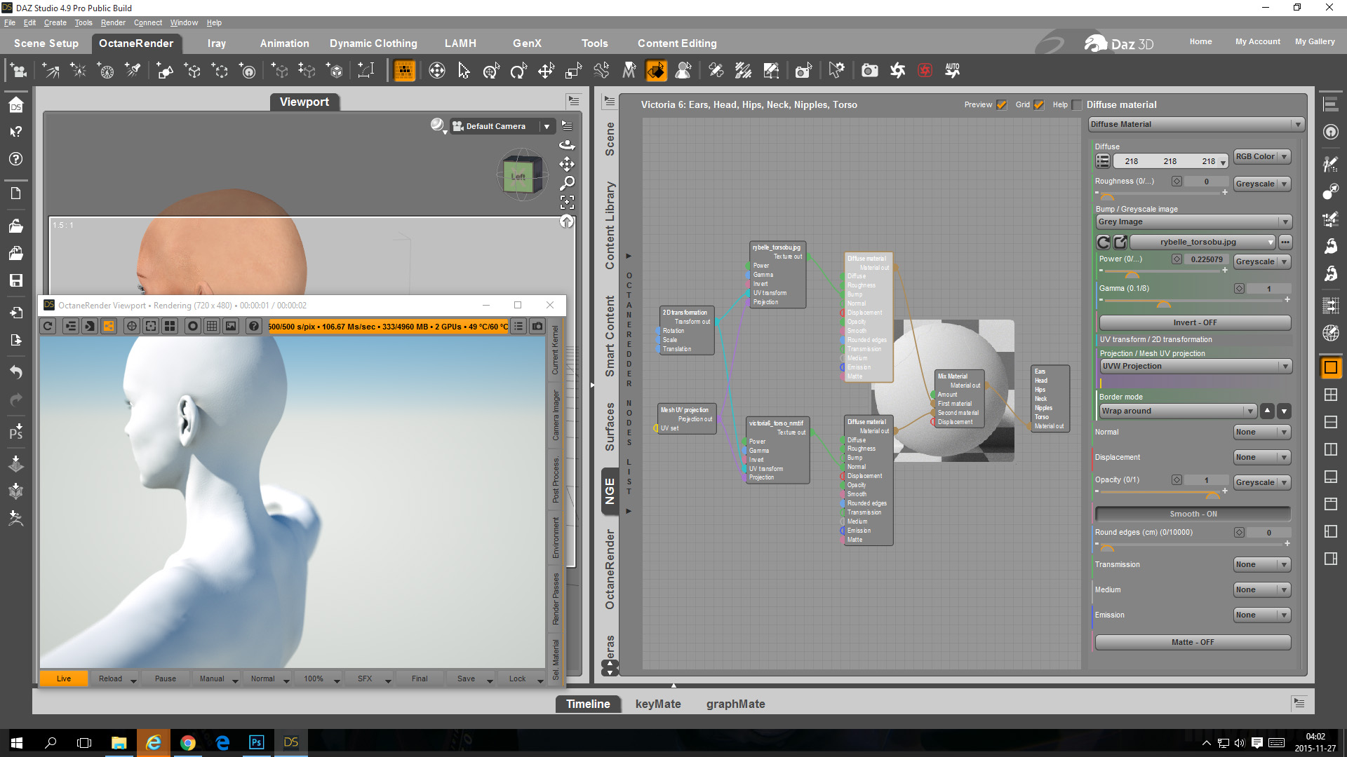

Currently you can observe another issue:
- For some reasons in some figure material setups the diffuse maps are not picked up with auto conversion.
I have not yet figured out why that is. It seems to happen both in 3Delight and Iray setups (Michael 7 Iray for example.)
I made the screenshots with the prerelease: OctaneRender_for_DazStudio_2_24_2_3
In 2_24_2_2 the diffuse maps were also not picked up.
BTW: Make sure to place a checkmark in the "Preview" box at the top border of the NGE.
That way when clicking on a node you can see a preview render of a sphere with the node applied or a 2d image of the map.
