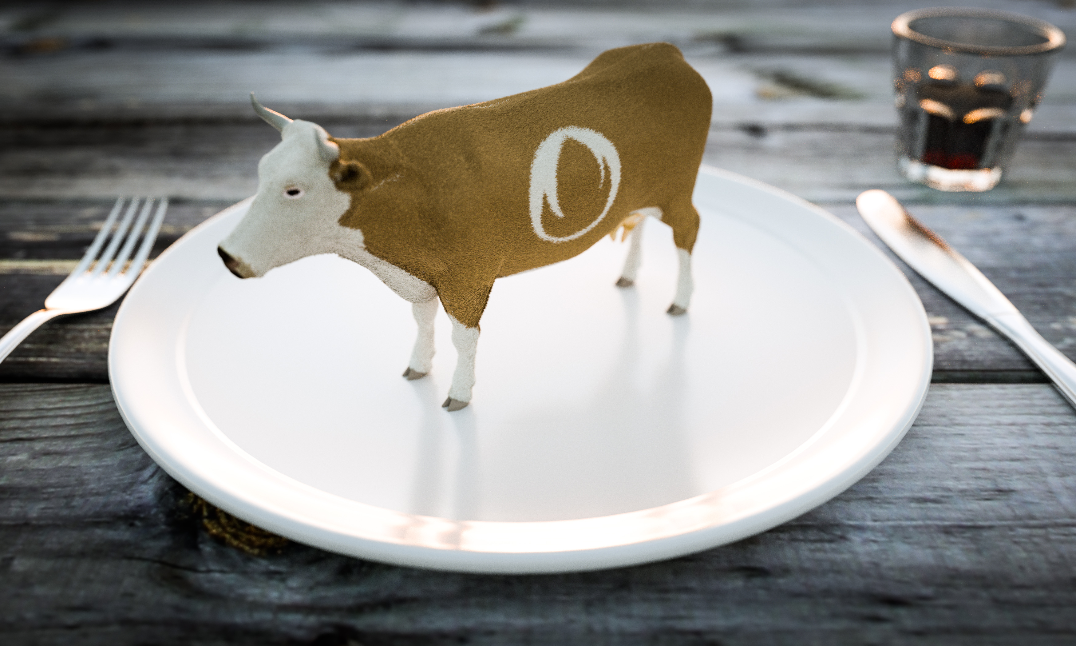

btw. I once used forest pro / octane for the (short) hair of a cow. looked great :)

you can control direction with a color map in FPP. i didn't do that however.. and you have to be in uv mode when i remember correctly. but you are of course right. forest is not THE plugin for hair hehe.
here my cow. was for a birthday gift card. the gift itself was a huge amount of organic meat (half a cow) :) therefore the organic logo on the cow.
