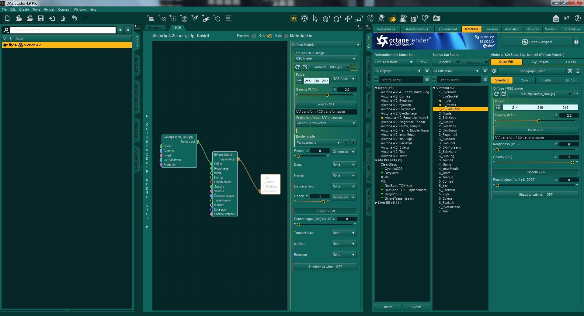

Posted: Sun Jun 05, 2016 4:08 am
by Spectralis
I'm having a problem with UV transform and Octane materials in the latest plugin release.
TEST: load plane, load Octane parquet material, UV transform is set to non-specific but is really 3D not 2D. Need to change UV transform to 2D in NGE. I think there's a problem when loading materials with the UV transform setting in the .22 release. I've written more about it here:
viewtopic.php?f=44&t=54489
