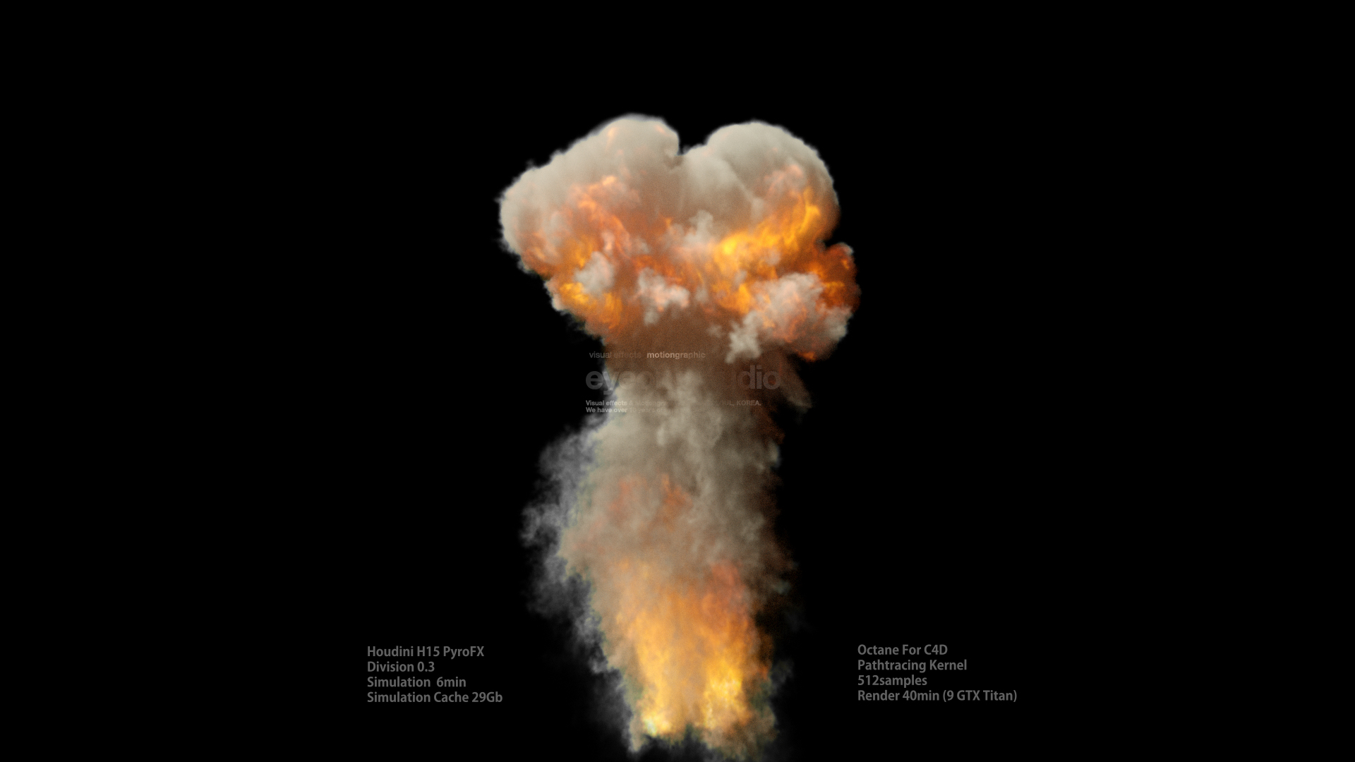

by eyeonestudio
OpenVDB Render Testing (Houdini H15 + Octane For C4D)
Enjoy.... :D
https://vimeo.com/164972765

by dinf
eyeonestudio wrote:OpenVDB Render Testing (Houdini H15 + Octane For C4D)
Enjoy.... :D
Hey,
how did yo solve the field question? =>
eyeonestudio wrote:I want use all field (each mapping - absorption, scatter, emission) :D
Special version?
