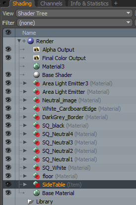

Posted: Fri Apr 11, 2014 3:02 pm
by lightboy
Hi Paul
This is how modo imports an objects materials.
It puts it in an item mask and adds another base shader into the item mask then it places it above the default base shader.
When you render in Modo everything is fine. When you transfer it over to Octane and create emitter overrides for the area lights you won't see any light in the scene.
To get the Octane lights to light the scene you have to move the imported item down the shader tree under the Octane created area light emitters, then the lights will work.
I don't know if there is an automated away around this?
Here's a couple of pics to show what I mean.
Modo default import
Modo default import
Octane lights friendly

Posted: Fri Apr 11, 2014 3:15 pm
by lightboy
I should of done some more checking.
You have to move the the imported item with the material mask to the bottom of the shader tree so as to not affect any other materials in Octane.
Octane_below other materials
This looks like a bug in the plugin. Would it be possible to send me the object you are importing pls? That way I can reproduce the exact situation you have to more rapidly fix the problem.
I have investigated this further, and cannot reproduce the issue. Can you pls send me a scene which demonstrates this problem.
