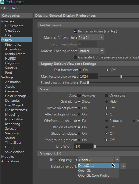

renmaxhb wrote:Material lost textures allways when open a maya scence, the poly is defaut material, must click the texture reload button every time.
itsallgoode9 wrote: no way in hell i'm going through a node graph like this to manually reload every material, as a quick fix....
This bug is triggered by the viewport Material/texture display (Yes you read right, a viewport issue triggers a render bug :shock: ...)
The workaround for this bug, is to use a viewport 2.0 mode that is not supported by Octane texture display
-> so you will have grey display of Octane Material in viewport 2.0 but no bug at render time
WORKAROUND = set the viewport 2.0 mode to DirectX or OpenGL Core Profile.
more information on this bug here:
viewtopic.php?f=110&t=60965#p312981
