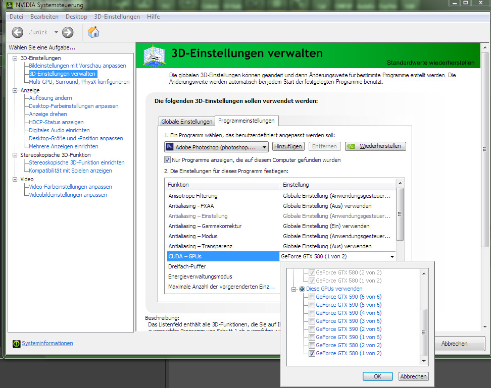

Hi BorisGoreta,
I have a non SLI Setup, non of my GTX cards are connected by SLI.
I set the GPU activation with the NVIDIA system control panel, and yes, it is mentioned as CUDA, but seems to affect Open GL, too.
Here for example for Photoshop:

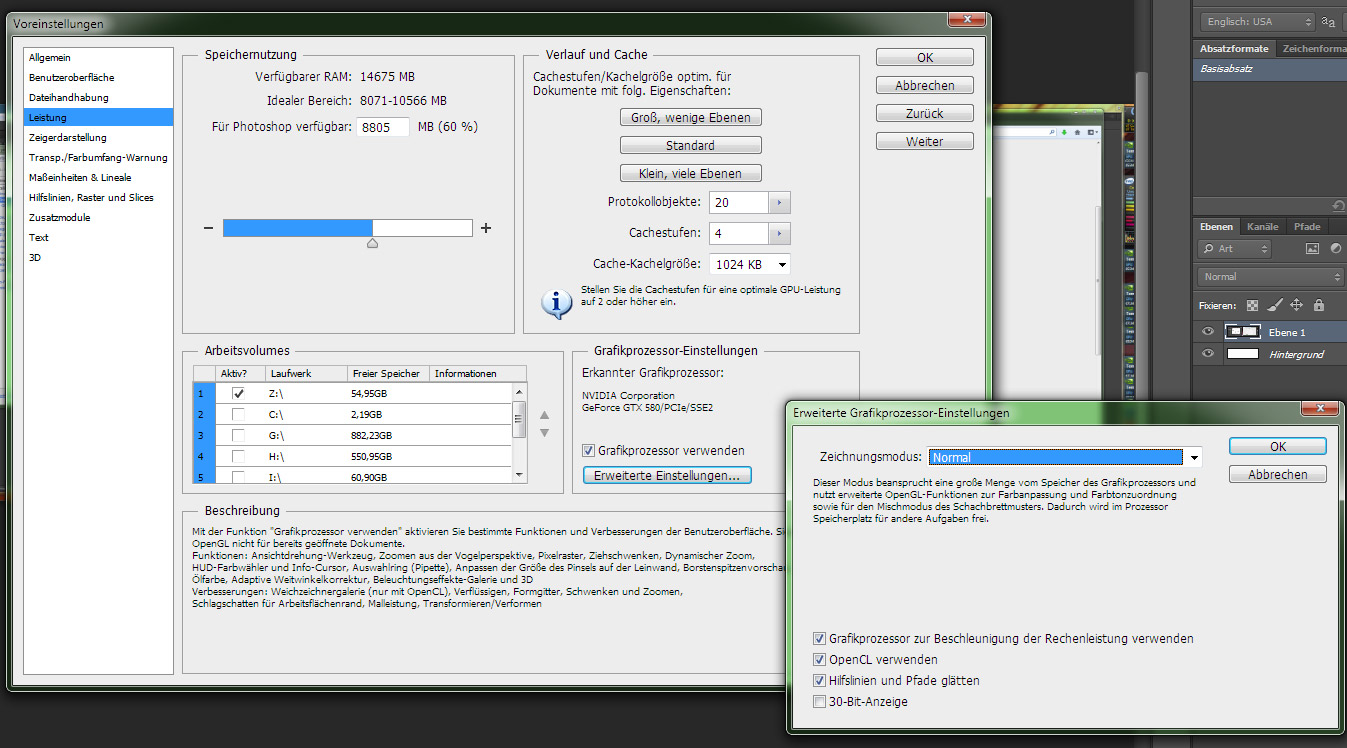

And here the settings in Photoshop (seems to use OpenCL, not OpenGL?):

All these pictures were made while my other 7 GPUs are rendering an animation in C4Doctane at full load. So one GPU left for the other programs and somehow C4D handles to use the one left GPU (the GTX in my PC) for OpenGL preview, too. So I can still smoothly browse and work on another scene in C4D while rendering.
I`ll check my Open GL versions later with the utility you mentioned.
Maybe Lightwave handles the GPUs somehow different? Did you try to determine the CUDA gpus with the nvidia control panel for the lightwave.exe?

Thanks for your report. Problem is that even if I set the global CUDA options to use only 1 GPU I still get OpenGL 1.1 which are only some basic OpenGL functions. When you boot into windows please check your OpenGL version.
Do you have regular nvidia drivers installed or some CUDA special drivers ?
CUDA swithces work for CUDA but have no effect on OpenGL.
I don't understand how can your system have good OpenGL with so many GPUs.
