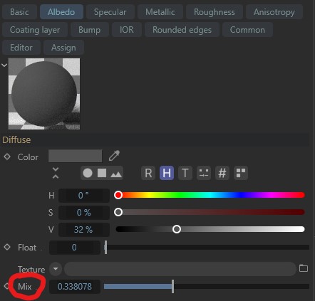

Using mix in Albedo channel cause huge 10-15 seconds ( depends of scene complexity ) lag, freeze of whole C4D while editing nodes. Other channels like specular, metallic works fine with mix. Tested in Universal and Standard Material

SSmolak wrote:Using mix in Albedo channel cause huge 10-15 seconds ( depends of scene complexity ) lag, freeze of whole C4D while editing nodes. Other channels like specular, metallic works fine with mix. Tested in Universal and Standard Material
Image Adjust node, brightness adjustment - these sliders value ranges are totally out of way. Most of them should have values from -1 to 1. There is no way to adjust using sliders. I reported this many times...
Most likely you have something specific to you that's giving lag. Be sure "Faster viewport textures" are ON and alternatively use low viewport texture resolutions for the material. Even make your material from scratch or delete some textures until find the problem.
