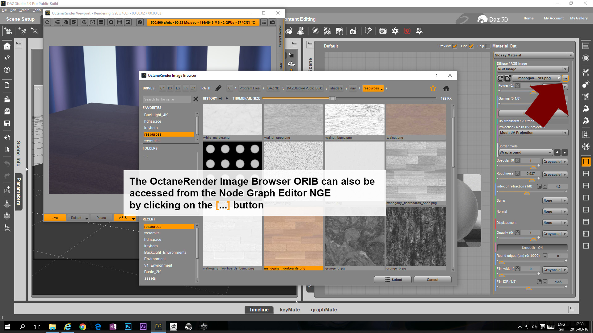

I experimented with the OctaneRender Image browser ORIB and loading images in the past weeks and was not able to produce a crash from the ORIB.
Retested again with
OctaneRender for DAZ Studio 3.0.6.16
Daz Studio Pro BETA - version 4.9.1.30 - Products installed with DAZ Connect
with .jpg, .hdr, .png, .dds, .tif, from a few kb to 50+MB file sizes.
Does the ORIB also crash for you when you access it from the Node Graph Editor NGE and change any other file type than .hdr?
