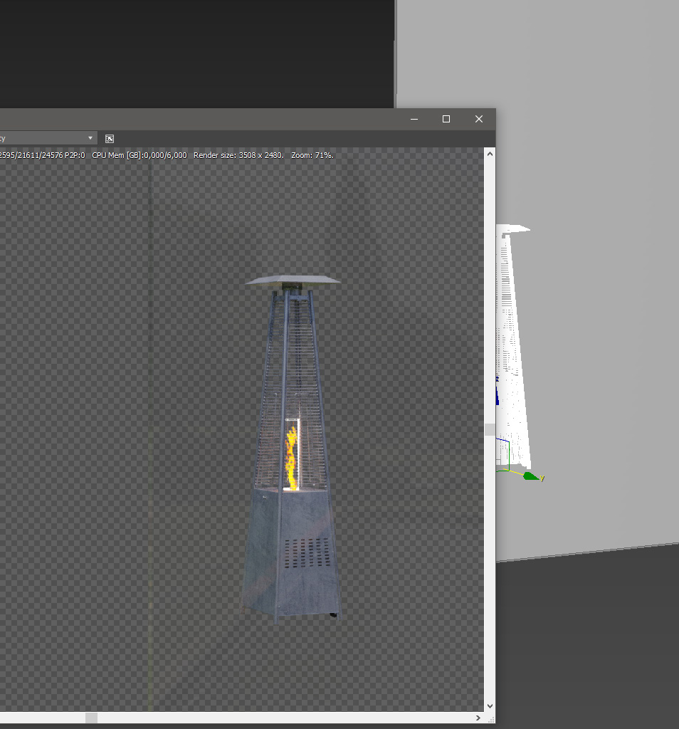

mbetke wrote:I noticed the opacity of my flame gets killed as soon as I move it behind the large glass (specular material).
Hi mbetke,
enable the alpha shadow in Kernel panel.
Regards
Paride

It is enabled of course! I'm not talking about shadow. The Opacity is just gone. I can see the white background of the flame. When I move the object a meter, so it is not covered by the glass panel, the flame looks right and has its opacity turned on.

Hi mbetke,
could you share the flame please.
Regards
Paride

Hi mbetke,
I think it depends on some .png issue.
Making a new .png it seems to work fine.
Regards
Paride
